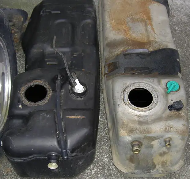

What does the top of that fuel tank look like? Here's a typical 95-01 Explorer tank from the US; the steel one on the right(left is 93 4dr Limited).
My '01 ST has the odd 3-port fuel filter. I have no idea what the extra port is for. I've replaced the fuel pump and it was identical to the fuel pumps used in all my other Explorers/Mountaineers. I didn't see anything different about the FP assembly FPR or fuel tank connections either. I asked the ST forum if anyone knew what the extra port and line were for, but I got no responses.
