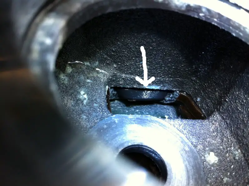

Got a better look at my leak just now and I think it's just like most everyone elses here. I snapped a couple photos after I took out the thermostat. First pic shows the inside where the thermostat sits. I noticed there is a piece of rubber sticking out on the backside.
I can push in on the rubber gasket whatever thing and see it move on the external backside of the housing, right where it leaks from. Is this piece out of place? Thus the the source of my leak? Or is this how everyone else's is?
Here is another pic looking straight down on the backside where the coolant is leaking.
I wonder if while replacing the thermostat a few weeks back, this seal slipped out of place. The two top screws for the outlet actually go all the way down and tighten to the intake.
Can anyone tell me anything about that rubber piece? Is there a coolant path there as well?
I have to say (unfortunately) those are some great shots and will probably help a lot of folk understand what we are all yammering about. Looks to me like you're going to need a new manifold. Like I've previously stated, don't, don't, don't use the Dorman manifold sold at the local parts house. Get genuine OEM Ford. After tons of checking, Tousley Ford's prices were way better than anyone else. Depending on the build date of your truck, you may/may not need the alternator bracket. They will be able to tell you by the VIN. Ask for "Bear". Great guy and very knowledgeable.
Also, (and I'm only suggesting this because I don't know you) if you are going to do the job by yourself, have a decent 3/8" drive torque wrench on hand and a few universal joint extenders. The back of the manifold is a pain in the as if you don't. Probably a good idea to change your plugs, water pump and belt (if any have not been changed) while you're in there.

EDIT: I looked a little deeper and I think the piece that broke is actually part of the manifold itself. Not the crossover...:(

I do NOT think you can replace that part (or the gasket for that matter) on a 2002 Explorer.

just replaced my intake manifold due to a slow coolant leak, looks worst than I thought. The gasket is intact, it's the manifold that's broken.
