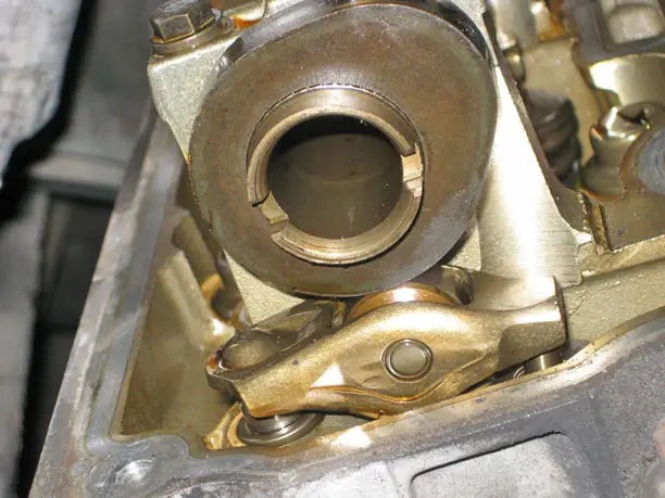

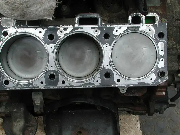

valve damage?
If a timing chain actually broke it is probable there was valve damage.
Did you check the valves and replace as required?
If you PM me your email address I'll send you a copy of the engine assembly instructions. Reviewing them may identify something you did incorrectly.
After an engine disassembly and reassembly it is common to have noisy cam followers due to excess clearance. It may require driving for about 20 minutes at engine midrange for the hydraulic pressure to build up in the hydraulic lash adjusters.
THANK YOU so much for the reply. I did have 2 bent valves that BARELY kissed the top of the piston, like even LESS than the photo you had posted. They were replaced and everything else was inspected. I have my re-assembly instructions from ALL-DATA and it went together smooth and well. Used the specialty tools, aligned TDC and the cams, truck fires right off, but the engine has an apparent vibration within the mounts and sounds a little off when put under load (Putting it in drive or reverse). Torque converter lighted up great and there was no forcing or problems of mating or anything between the engine and transmission.

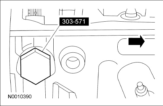

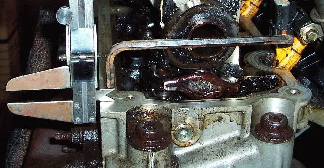

camshafts & crank held in position
. . . Another concern of mine is that I did use the timing kit, but the cams were moved several times while being off the engine and I do not know if they were put back at true TDC. I listened to the instructions off ALL DATA and the other guys on the forums but there is no specific mark or pin to line up so I do worry that it is off by a few degrees. Is it possible to adjust timing without pulling the engine again? . .
The OTC 6488 timing tool kit contains a tool to hold the crankshaft at TDC.
The kit also contains two tools to hold one camshaft in the correct position.
If the tools are correctly installed the camshaft cannot be out of time relative to the crankshaft. There is only one set of camshaft holders and sprocket holders in the kit so only one camshaft can be timed with the tool kit. Then the camshaft tools are moved from one camshaft (usually the passenger side) to the other (driver side) making sure to leave the crankshaft holder in place.
The timing can be checked and the camshafts retimed with the engine in the vehicle and the valve covers removed. There's another special tool in the kit that fits between the firewall and the camshaft sprocket for tightening/loosening the sprocket retaining bolt. A different torque setting is used because it adds leverage.
If the precision tensioner in the tool kit is not used then the camshaft timing can be a couple degrees off because the timing chain is not taught.
I suggest that you review the following thread: SOHC V6 Camshaft Timing and then check the timing. I advise against running the engine until you fully understand the timing process and make sure the timing is correct.
