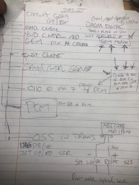

Do it exactly as shown in the thread
Yes you can use the gps enabled dakota

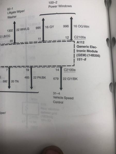

You must and I mean must tap into the vss wire where I did just before the abs pump
And the feed must go into the truck where I put it going to the gem speedo etc
I can provide wiring diagrams for 2002 truck I do not have 03
The old ford cable driven vss (1986-1995) was calibrated at 8000 pulses per mile, nothing has changed on the truck side of things. In 96 the cable went away and the speedometer itself was now electric and also needed the 8000ppm so the gem module did the “math” or buffering needed… then later the engine computer did the math…. And it accepted inputs from the iss and oss on the trans… Now When we remove the pcm all of that goes away. So we need to add a module that can take any speed sensor signal (oss or vss) and perform the math needed to send the 8000ppm to the speedometer and body computers
All of our trucks have a vss in the rear axle, all 96-11 rangers, all 96-04 explorers, tracs, etc so that is the sensor I decided to use to run the Dakota. It is important that we tap in where we do so we do not effect the abs brakes
I am sure there are other ways to calculate the 8000ppm from various speed sensors
The Dakota is/was $100 and it is adjustable as you drive so with tire changes etc you can always dial in your mph making the speedo, new pcm, cruise control happy
I have used these now on trucks from the 90’s all the way up to 2005 now, it works awesome in every conversion so I am a big fan of the Dakota.
You can see the input and output settings I used to do the math to reduce the vss signal down to the target 8000 ppm, really simple when it is all said and done
Should work great for your 03 too

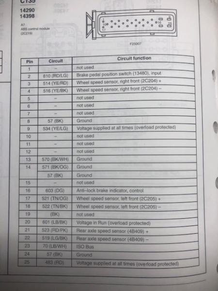

If you don't mind, may I see the wiring diagrams for the 02 sport trac please? I think I'll try to compare information from diagram to what is what I can see on the truck itself to see if any of the stuff lines up and go from there. I'm hoping that the sport trac didn't undergo any major electrical changes throughout the first gen run.
And I figured that the 02-04 sport trac is basically a ranger after tearing everything apart; basically all the information I used was for the ranger while doing the manual swap
Thank you
Page 3 of the 02 sport trac conversion thread actually has the 02 wiring for the vss circuit outlined. I even took pics of my hand drawn circuit diagrams for 679 the vss circuit after it leaves the abs module
When I get a few
Minutes I can take pics from the 02 book for you as well
