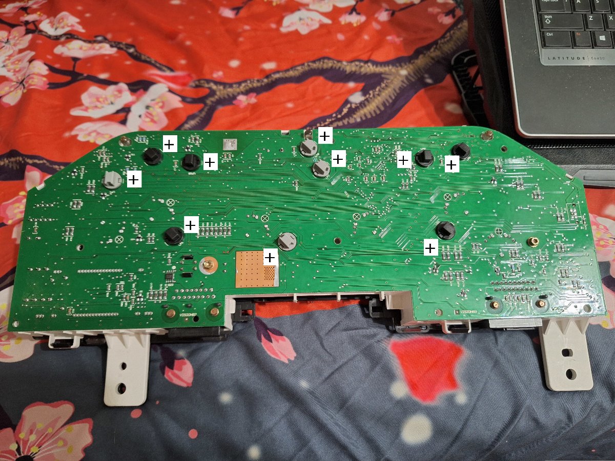

Because I could not find anything on polarity of the light sockets in the gen 3 cluster (I installed 4 wrong) I checked each one after they were all working and indicated where positive is on the back of the cluster after it is installed.
I figured I'd post this first so that if someone is only looking for polarity locations they wouldn't have to search through the entire thread for the info.

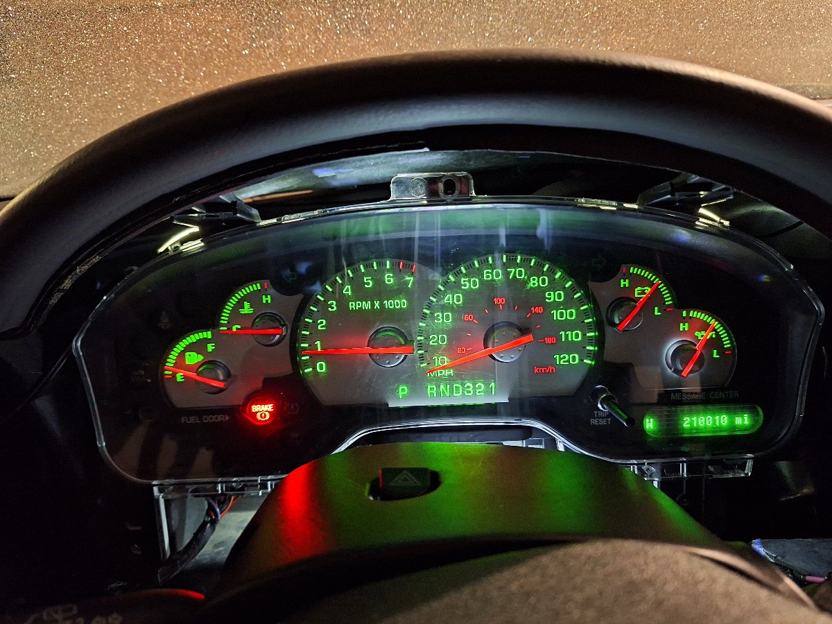

Here is the finished product.
Put back in the Explorer.
You can see that the lower MPH digits are not as bright as the rest of the cluster. Turns out I had 4 LEDs installed wrong. Hence the first pic in the thread. 2 were in the dials, while the other 2 were the turn signal indicators. Found those later, Had to pull over to check the exterior turn signals. Fortunately, those were still working.
So, before posting this thread, I put the cluster back in the Explorer. I took it out to put the plastic piece on the back and find the polarity positions for the LEDs. I must have goofed something up, because I one of the turn signal indicators are not working. But, because the exterior signal is still working, and because of the floating icicles, I will deal with that later. If I messed up on that polarity in the first post, I will post a correction. But, here is how it looks at night.
