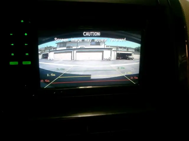

Finished Product;)

I bought the camera from Fry's, however it has been giving me trouble the last few days, with no consistency. :( some days it's black, some green, some the image is frozen, or reversed, sometimes, the are the parking lines, sometimes not. It's really a POS camera. But At least all the lines are run, it's nothing to switch the camera out. :rolleyes:
I found a ignition hot lead in the compartment where the sub woofer is, also found a large ground there. This is where I drew the power from
