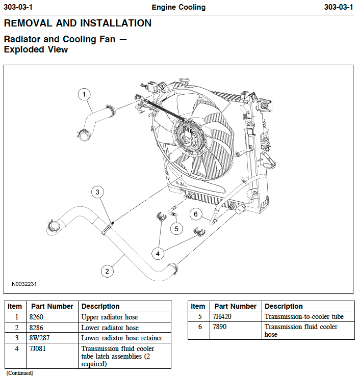

2007 radiator removal
did you replace it yourself? how hard was it? time required?
Just got finished with my replacement. Took me about 6 hours from start to finish. This guide was perfect.
Can I add a couple things.. I got away without pulling the fan. Also, I suggest pulling the thermostat housing and topping up the block before you fill the rad, or air gets stuck behind it and you get problems.
