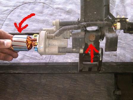

If I remember right, If the wedge is out it will spin forever; that is a good sign that it is spinning freely. no broken gears then, with the wedge out hold the output shaft of the transmission (that is were the wedge came out of it is flat on one side) and try spinning the motor shaft see it if slips any teeth. if it is clicking, slipping, crunching, noise there is something broken inside.
