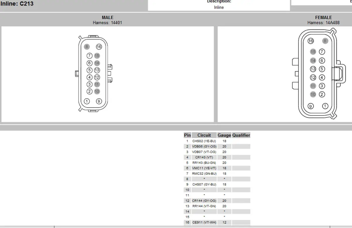

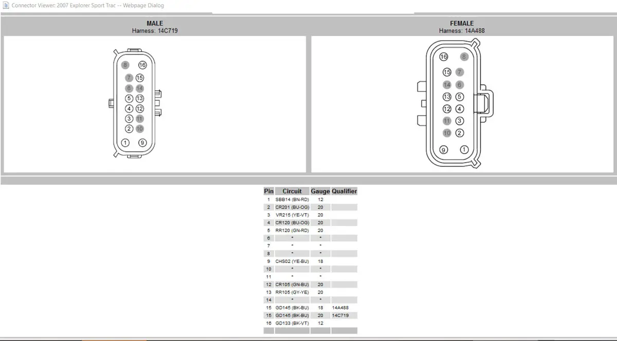

Id verify that its not a failed relay first. Then you need to test for resistance to verify you have a failed heater. At that point you need to source heaters. From ford only my guess. Remove seat covers, and then CAREFULLY remove the old heater. It is held on by adhesive, and if you bugger up the seat cushion you will have a very hard time sourcing a new one, might get lucky at a junk yard.
