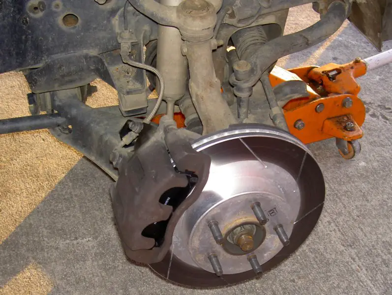

The bigger 12" brakes is an easy project you can do. Get any 01-03 Sport or 1st gen Sport Trac spindle, and put it in any 2nd gen Explorer. Then the 12" front rotor bolts on, it's just those two parts.
This is from my 99 Limited;
