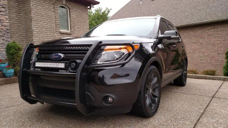

Yup! Getting ready to get the grill painted black as well as the rear chrome strip above the license plate. Then I'm adding a Selina push bumper and a Whelen pioneer flood light. Should look something like this....
http://imgur.com/uLPdBGK
