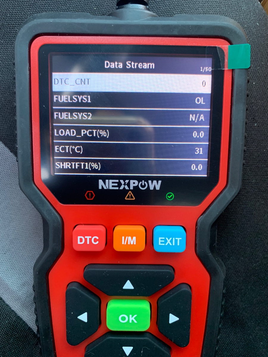

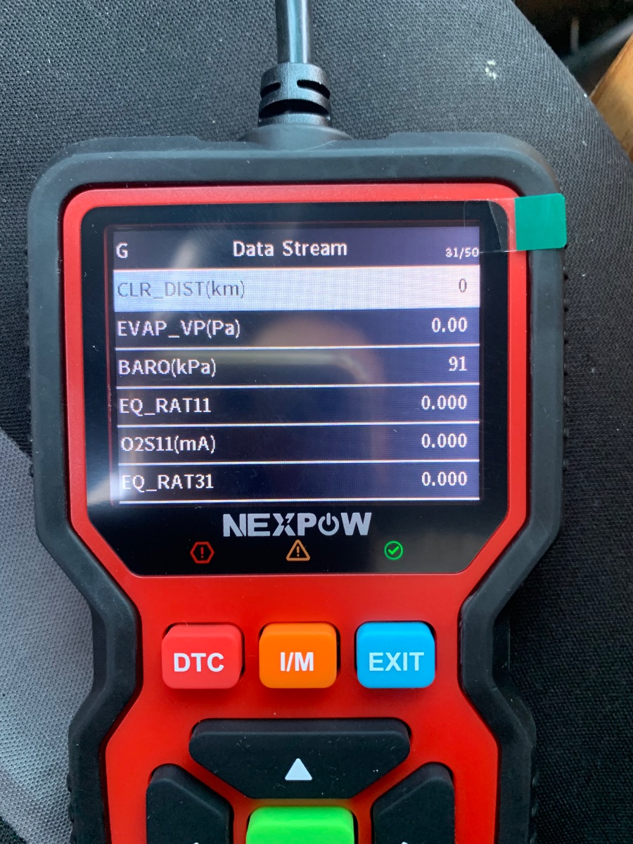

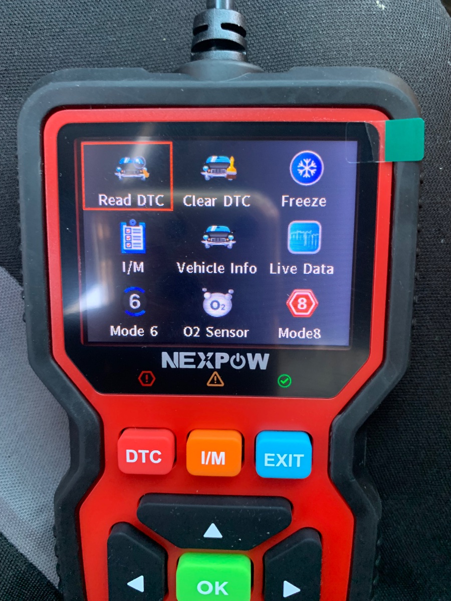

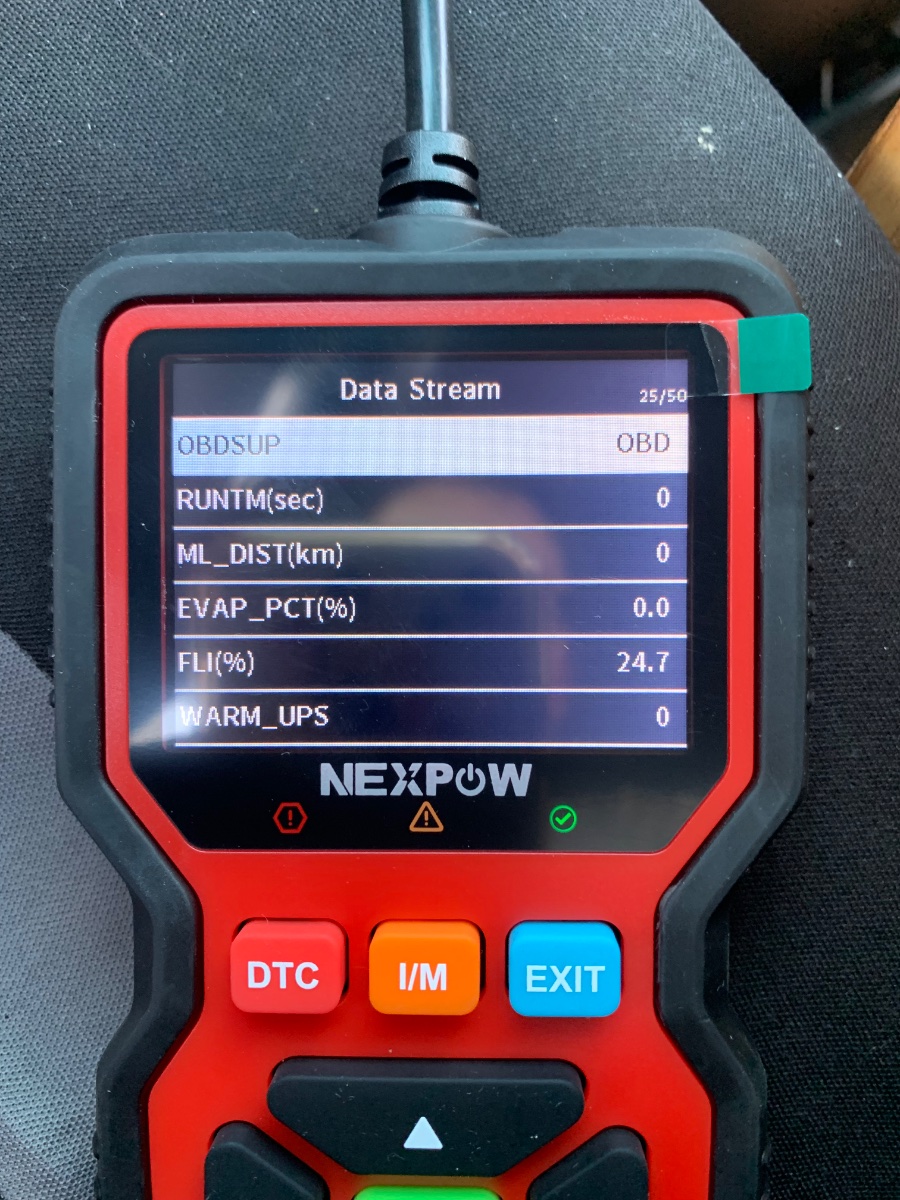

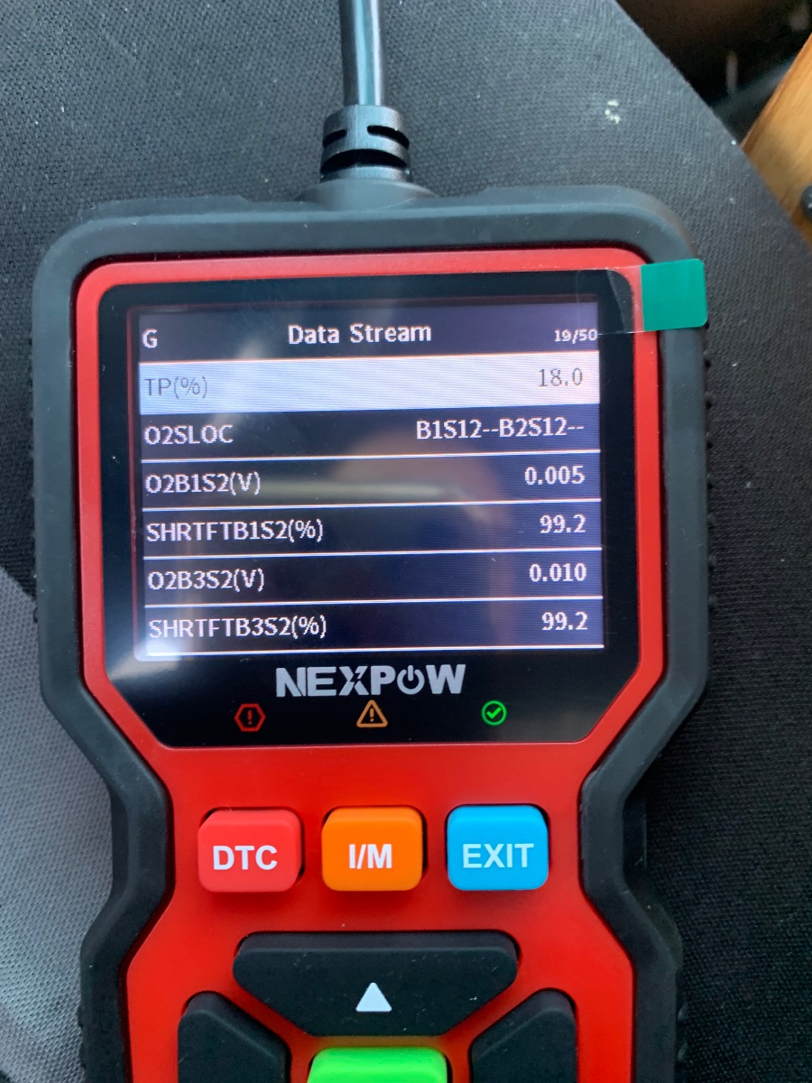

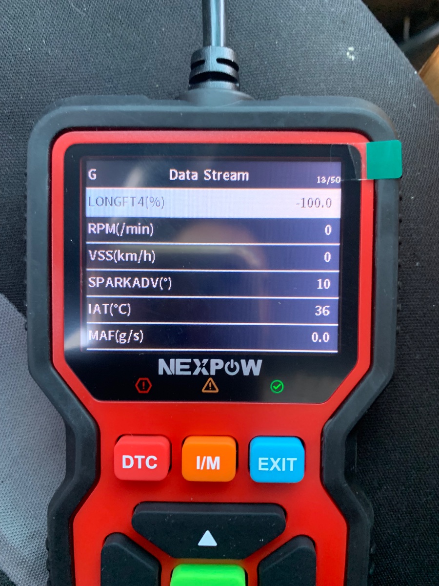

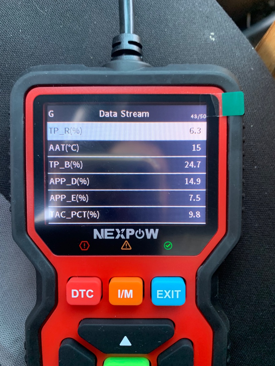

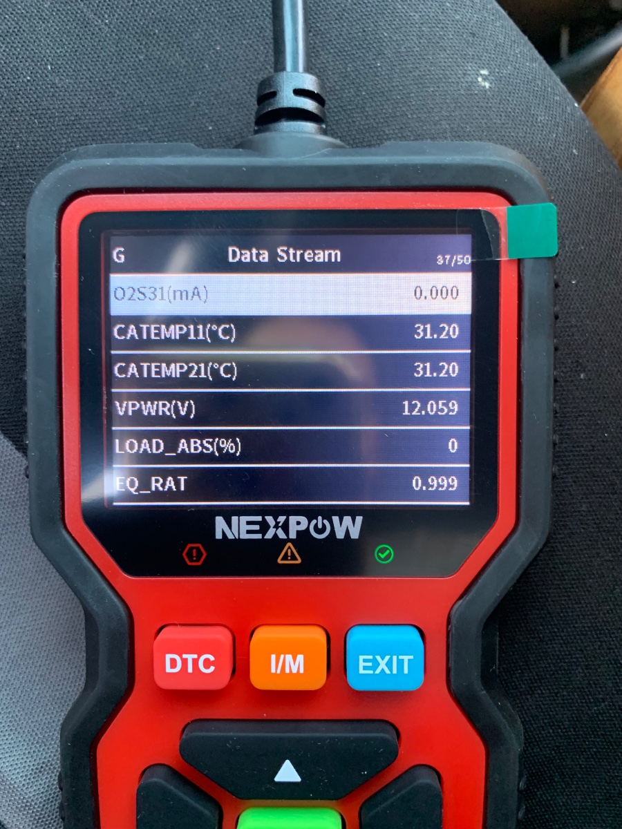

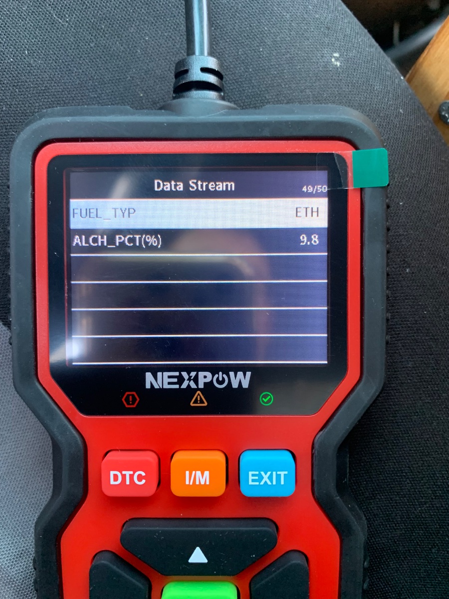

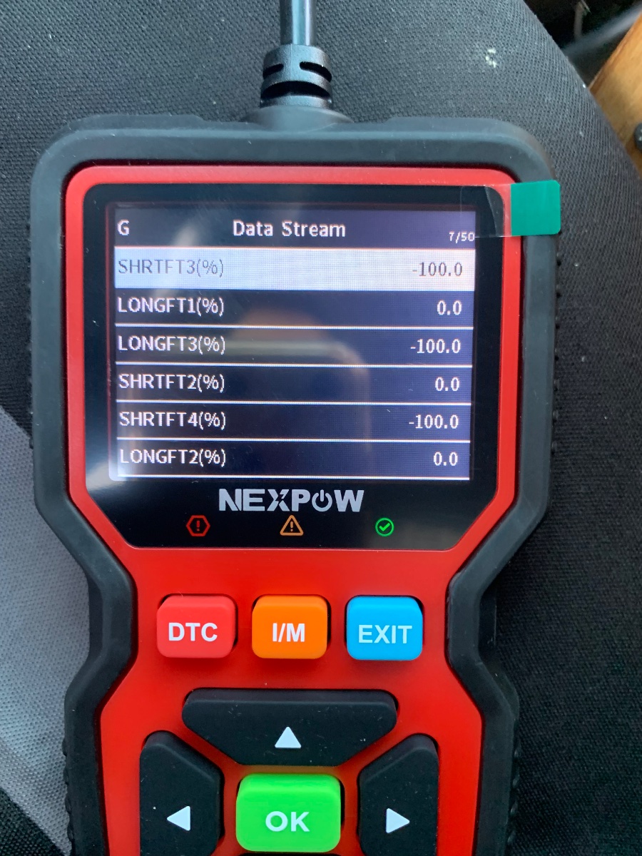

I put everything together and turn key on and get some live data pictures:
The IAT being negative 40 when I don't think you're at the north pole could be a problem as you'd run super rich upon start and run. What kind of fuel are you running. From what i gather it says ethanol but then says 9.8 percent. Are you using flex fuel?
I never used flex fuel. There is still about 1/8 fuel in the tank.
