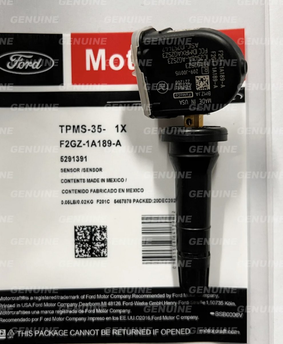

I have had a new sensor installed. It is oem ford. It’s doing the same thing the old one was doing no air pressure reading 2 dashes. So I tried the automatic relearn where you go on off ignition and brake pedal sequence with new sensor didn’t work. Then I bought a tool that’s supposed to wake it up drove it for a while also. Tried letting air out which worked on first tire but not tire with new sensor. I also tried with tool which works until I get to new sensor. Do I need to take ford?

I would post pictures of sensor and tool but it will not won’t let me have that option part number of tool is el-50448 for ford and gm and the sensor is f2gt-1a189-a 315mhz

That sensor part on the Ford website shows as obsolete or invalid. On the Levittown Ford site, it also does not show up.
Here is what Levittown shows.

It did have Z instead T on the ford package I just copy and pasted from eBay auction listing below is actual package
