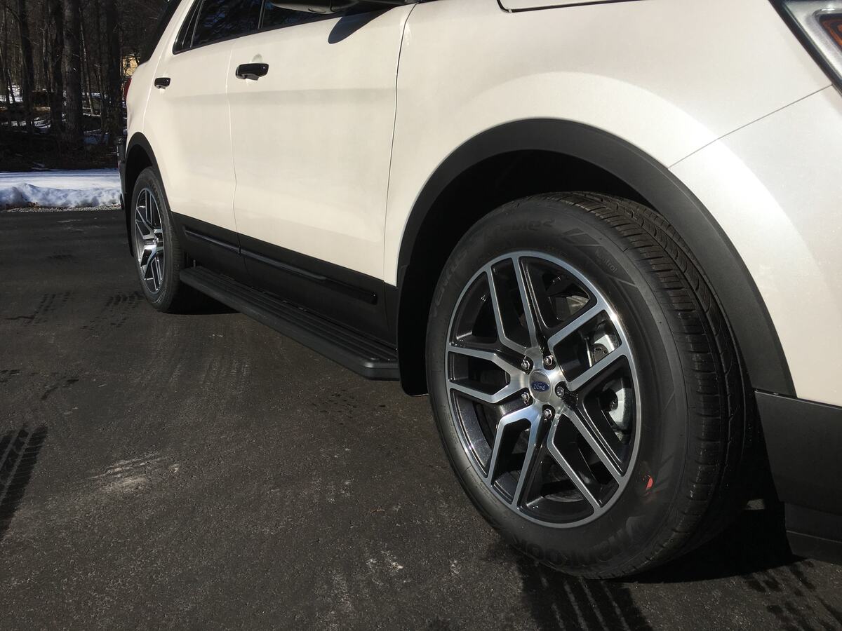

I did finally get my Ford OEM running boards installed last week, haven't gotten a picture yet - but why bother, they look exactly as they do in the previous link! They fit 2011-2017 Explorers. Part # HB5Z-16450-AB
I bought them from Tasca Parts Center for $401.94 + 34.81 S&H, no tax (any Ford dealer nationwide would charge tax on top of their higher price and delivery), did the drivers side install first which took about 3.5 hours, did the passenger side the next day which took just over 2 hours since I knew what I was doing then. The hardest part, as I mentioned in an earlier post, was that I was shorted one nut and holding washer, so had to figure out what I needed at Home Depot - cost a few bucks, if that (it's all metric if that might help anyone - I love metric for sockets, they're SO much easier! Still can't find a metric screwdriver though ;-) ). Actually, to be honest, the hardest part was putting in the new locking caps (5 on each side) that keep the under-door trim in place (best way I can describe it).
Good news and bad news. Tasca now has these for $385 but want $284 for oversized shipping! :eek:
That looks really nice. Btw, for a tip on how to post pics without an elite membership, you can just embed the link to a pic. Just click the picture icon while editing (the one with the sun and mountains in it), then paste in the link. In OneDrive, you have to click on the picture you want, and in the viewer screen, there is a small embed button above and grab the link from there. For me, I use snag.gy to post my pictures, you can paste clipboard pics in there, and the snag.gy links are easy to manage.

My guess about rogue shopping carts? No, the running boards don't stick out any further than my 20" tires. Actually they're inset a little bit. Some have said they're just good for dirtying the back of pants/legs and yes, this could definitely be true - but I have back problems so for me, they're great, mostly at getting in, but I do use them for exiting as well. I did have to train (force) myself to use them once installed to remember they are there but now I don't even think of it. When exiting, my foot now just automatically goes directly to the step. My husband, on the other hand, is more 5'11" and he doesn't use them. He loves the way they look, just has no use for them. And this picture here with the White Sport is gorgeous!
