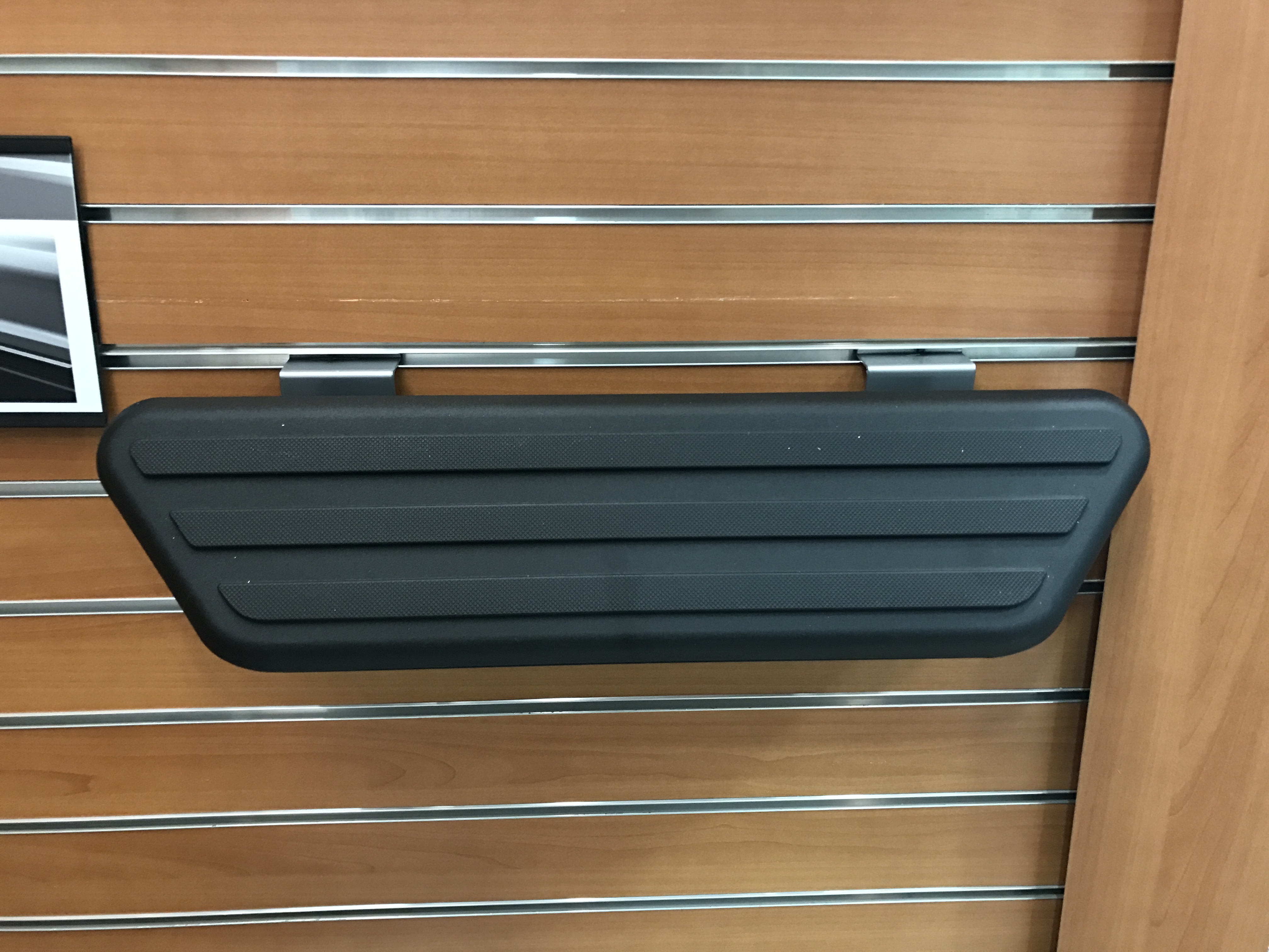

We're referring to the no-drill factory accessories running boards. I'll link you:
https://accessories.ford.com/catalog/product/view/id/11806/s/step-asy/category/154/
I did finally get my Ford OEM running boards installed last week, haven't gotten a picture yet - but why bother, they look exactly as they do in the previous link! They fit 2011-2017 Explorers. Part # HB5Z-16450-AB
