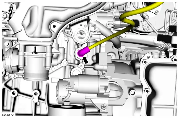

Front of the engine right above the starter, they screw in and you'mm need a pretty big socket to R and I it.

Front of the engine right above the starter, they screw in and you'mm need a pretty big socket to R and I it. View attachment 461261
33mm or 34mm? I can’t remember but yes a rather large socket. Ended up threading a 3/4npt brass plug in its place until the dealership could get one. They didn’t sound very sure of if/when they could get one. Crazy that a vehicle this new has parts that are not easily accessible. Also may I ask where you found that breakdown? Definitely will come in handy in the future
