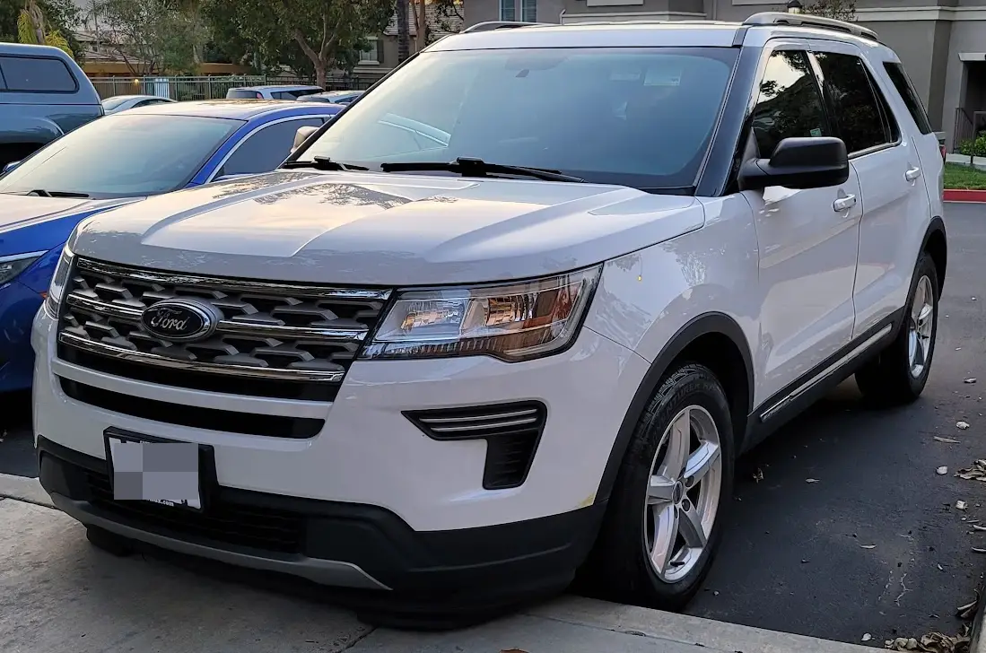

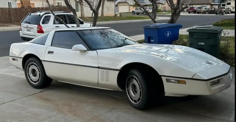

I need to make a 300 mile round trip from Fresno, CA to Murrieta, CA, traveling through the grape vine (mountains)... My wife's 2018 XLT V6 Auto is completely stock. Was looking online at amazon and found some 2" tow hitches and was going to just rent a uhaul trailer once I get to Fresno and tow my son's '84 Corvette back on it. Anybody think there will be any difficulty with this? Anything I should watch out for? I have no idea what the capability of this suv and towing is, but I figure this should be just fine. I'm also assuming a hitch and a trailer are all I need to get this one time job done...

The Explorer can tow up to 5000lbs if it has the tow package with factory class 3 hitch. If you don't have the tow package it is significantly less capable.
The trailer is probably 1500 lbs and the C4 vette is probably over 3500 lbs so you are exceeding the max rating.
Renting a Home Depot truck may be better option
The trailer is 2210 lbs and the corvette is 3200 lbs. U-Haul won't rent you that trailer with your explorer. Even if they did, you'd be in for a ride going over the grapevine.
Am I missing something? Was there a history of uhaul not renting out trailers to explorers? lol
Welcome to the Forum. :wave:
Yes, U-Haul did have a policy in place for Explorers but not for the 5th gen. Several members have rented U-Hual trailers for various purposes.
If your Explorer does not have the factory-installed tow package then you are legally limited to towing no more than 2000 lb.
