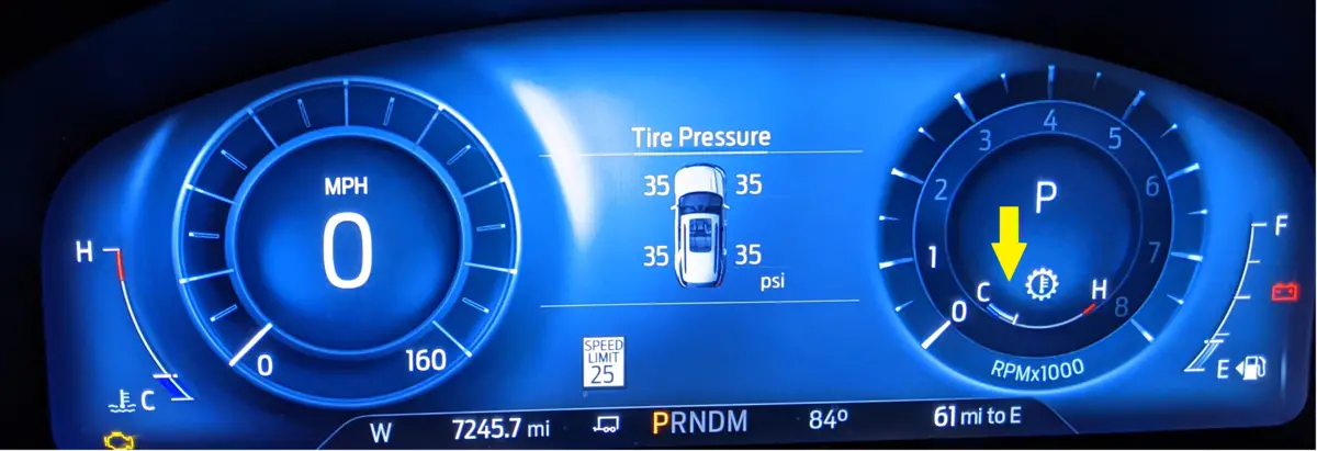

On my 2020 ST, when you go to Tow/Haul mode, the dash displays a transmission temperature gauge. Does the XLT without a factory tow package have that drive mode, and if so, the transmission temp gauge? That would let you know how it's handling the camper.
Where does your transmission temp show up? Towed my trailer with my XLT last week, but no transmission temp display so far.
It's been parked at least an hour and obviously this pic is with the motor off, but the temp gauge normally runs near the middle for me. I have no idea what that translates to in actual numbers.
Nice. Looks like it’s only a feature of the digital dash then.
The temp gauges are dummy gauges. They have about a 50 degree swing without it moving (stays right in the middle).
Why do you say that? I do see mine going up incrementally from a cold start, at least. Granted I'm not staring at how small the increments are, but did you or somebody do a comparison to known-good measurements while operating?
Because using forscan you can see the actual temps and can compare how much the temps still climb once it hits the middle of the gauge on the cluster. There is around a 50 degree climb of actual temps after the gauges hit the center.
So example, around 150 degrees it hits normal and doesn't move again (I'd have to check the exact number.. just an example). Even though it shows mid/normal and doesn't move again, your temp still rises up to abou 200 degrees. It won't drop at all unless you get close to the 150.. and won't rise till you get above 220. So thats why I say it is a dummy gauge, it doesn't actively move with the actual temp fluctuations.
Cool to know, yet disappointing information. Thank you for explaining! That's crazy that the digital gauge would be programmed with such low precision. They probably decided they would get less unnecessary warranty work from people fretting over their transmission temperature fluctuations or something. Speculation on my part, of course.
Pretty much the consensus of many.
