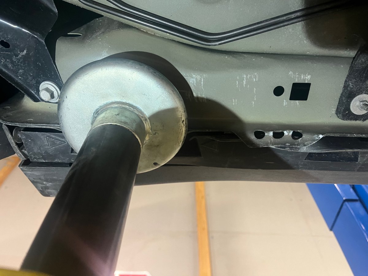

I went out to my shop, put it on my lift, checked the rack and found a pronounced clunking on the drivers side of my steering rack and none at all one the passenger side. Wow, found the issue in the first minute of looking.

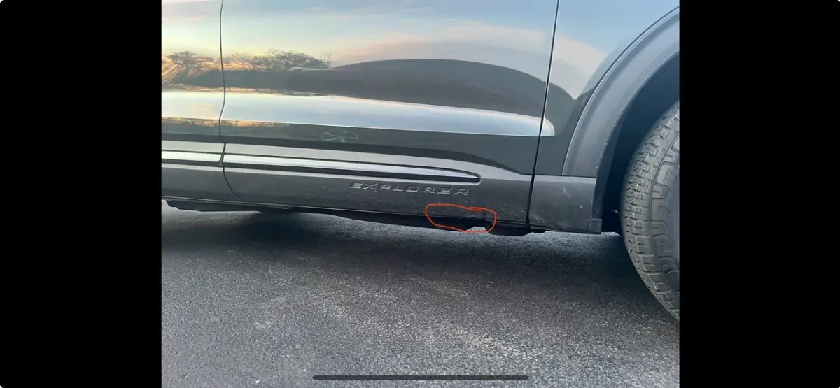

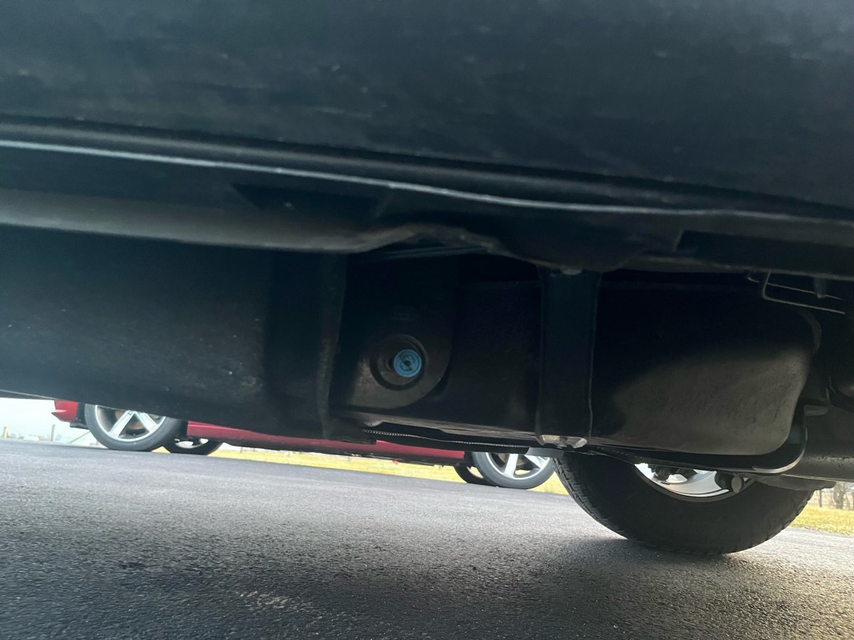

Also I found they had
#1 damaged my drivers side body by lifting it at the wrong spot,

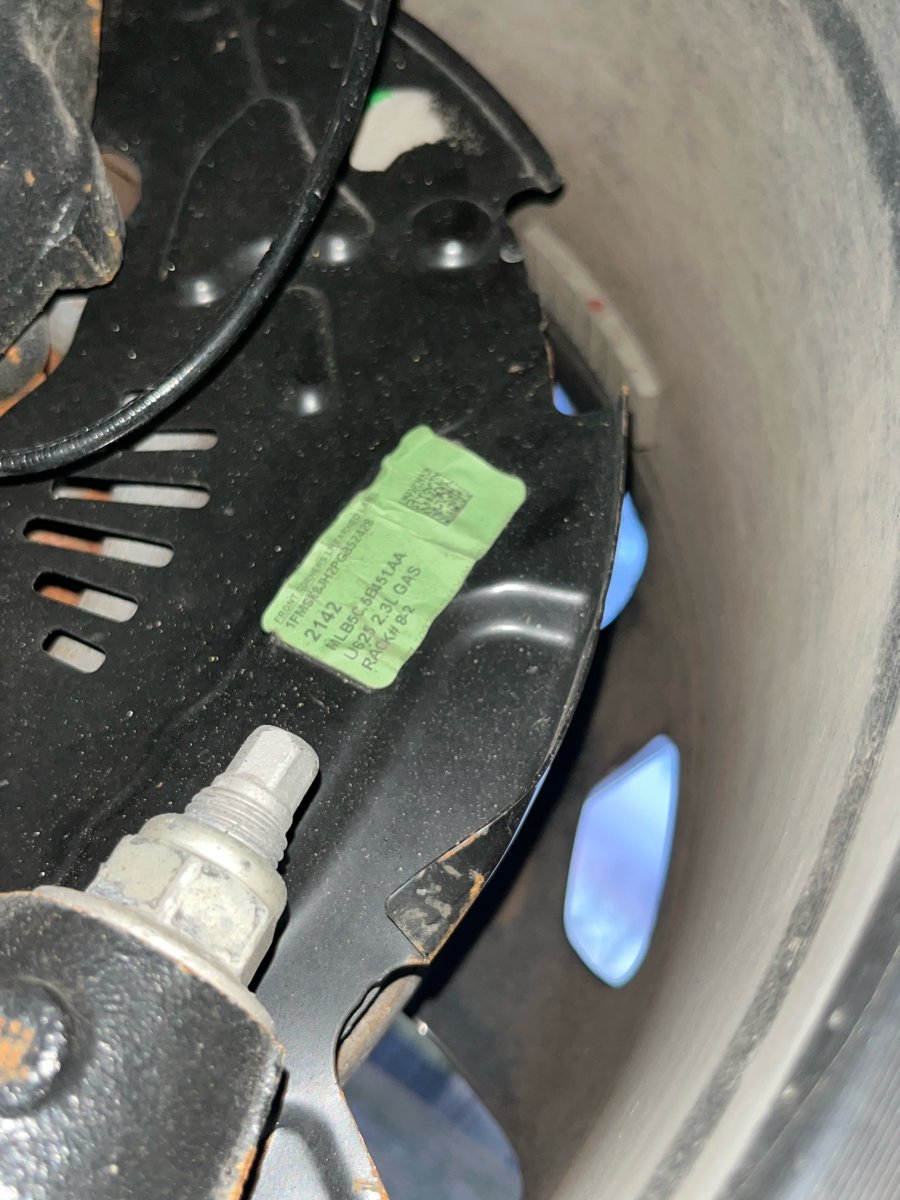

#2 damaged my drivers side front brake backing plate by bending part of it out of the way like it was some piece of junk beater car to make it easier for them to access a nut when they has change out the knuckle/control arm,
#3 bent my body trim on the passenger side while lifting it with their jack.
