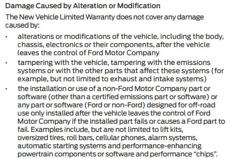

They are wrong, I don't know who you talked too, but they are wrong. I know the Magnuson-Moss Warranty Act, it protects you by saying they have to prove that the part causes the problem before voiding the warranty claim is voided. Any non-aftermarket part has the possibility of voiding warranty. Lift and tires are not OEM and are not even Ford certified part. There's nothing wrong with that, but it has the possilbility of voiding warranty.
This is from the 2023 Warranty Guide.

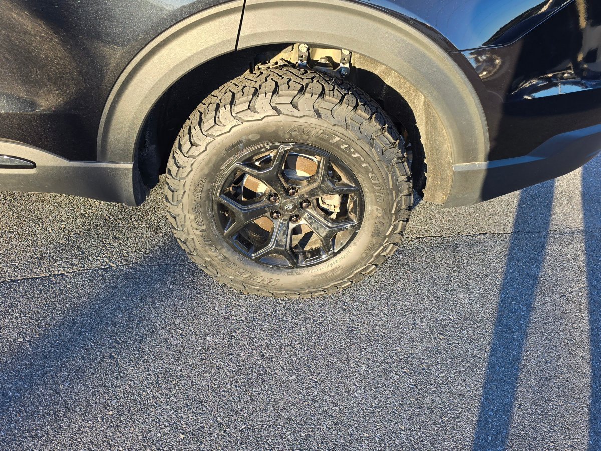

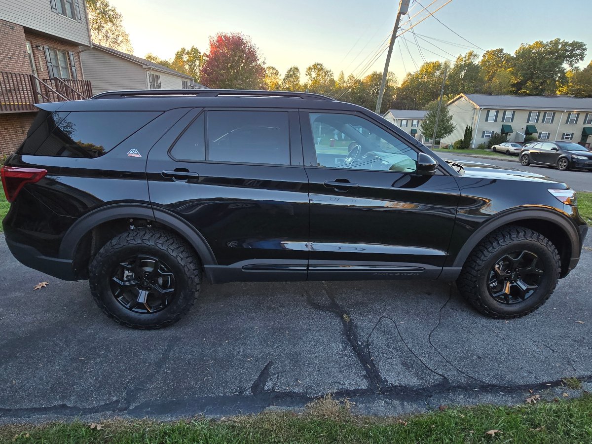

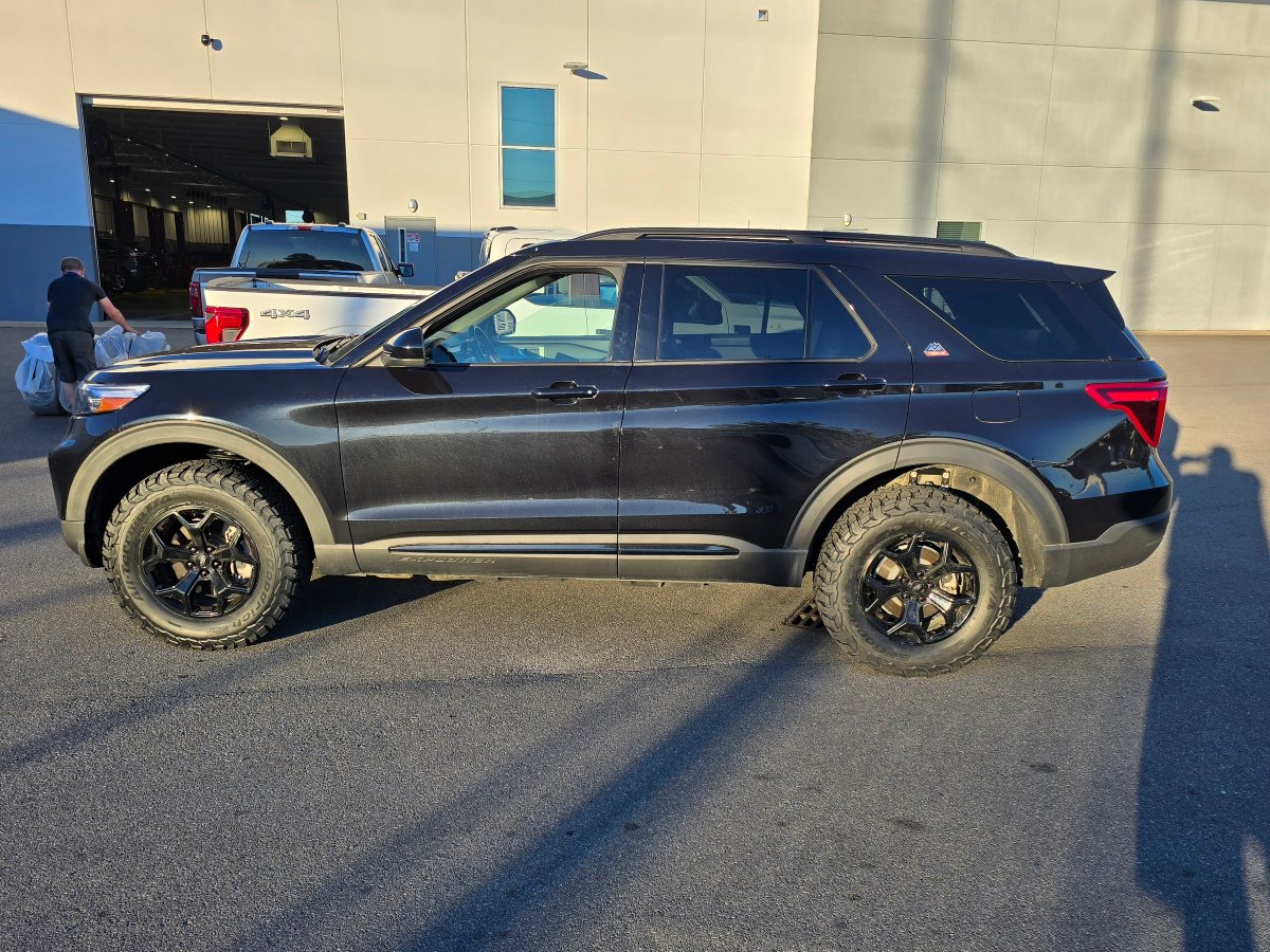

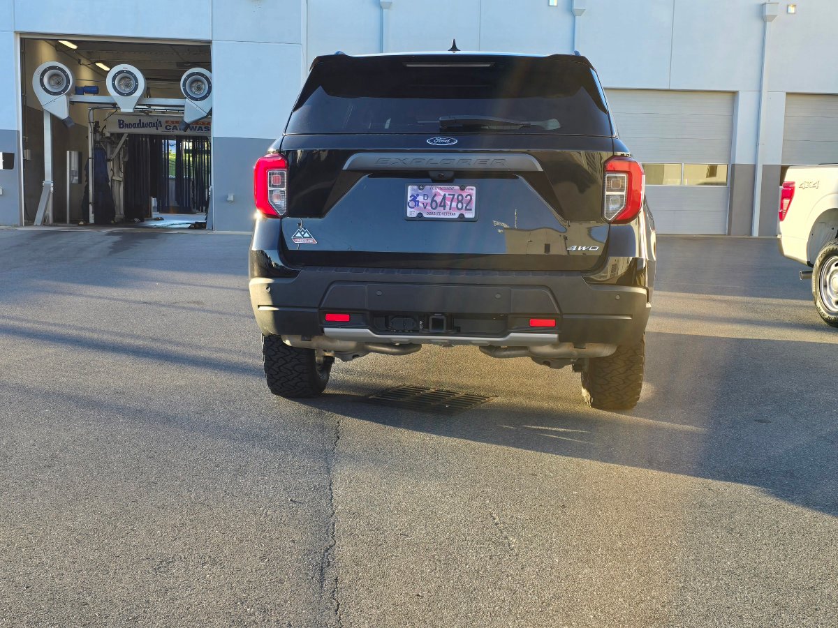

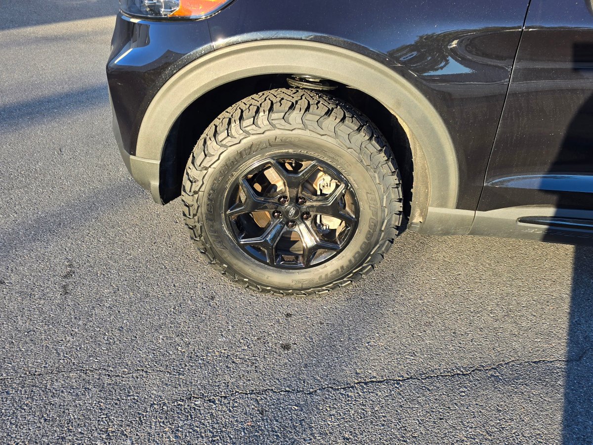

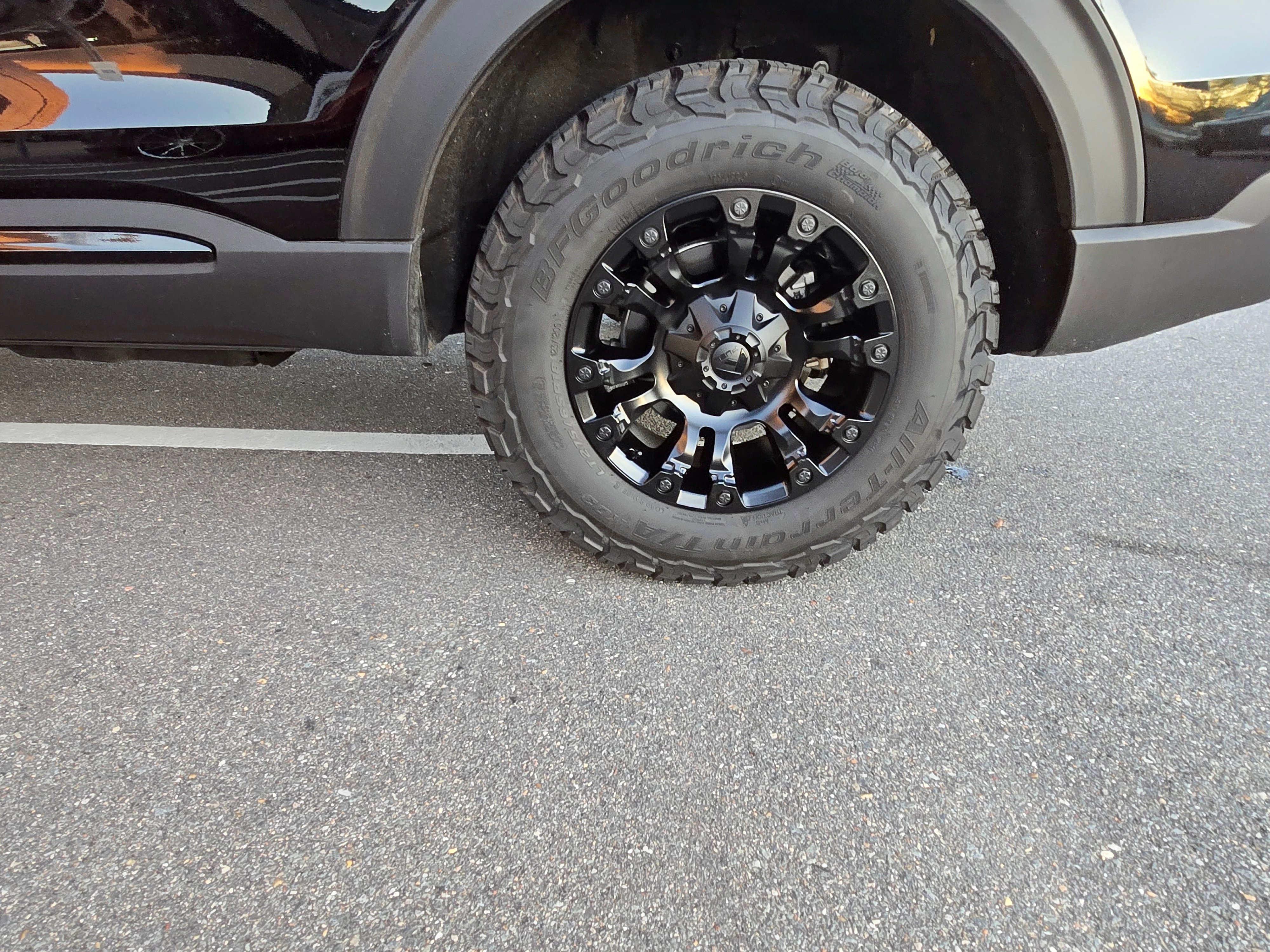

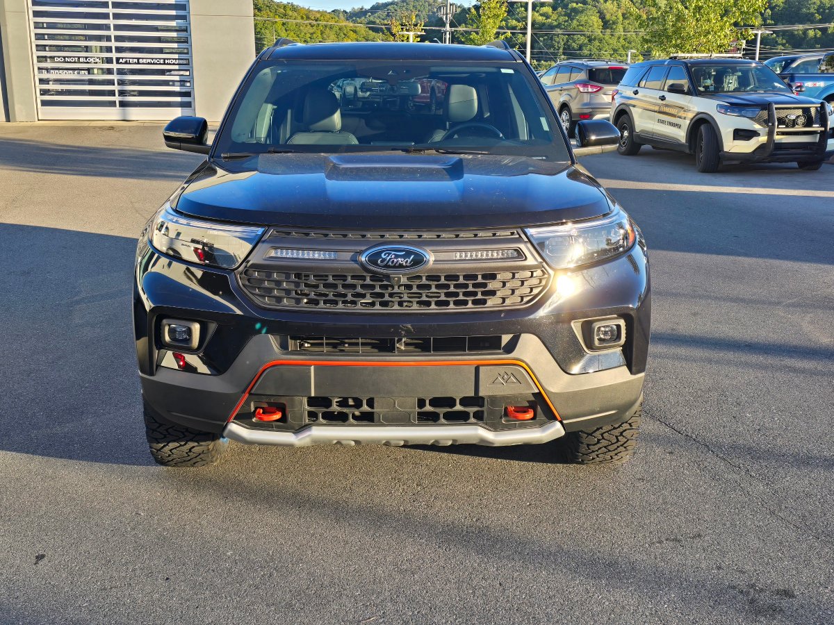

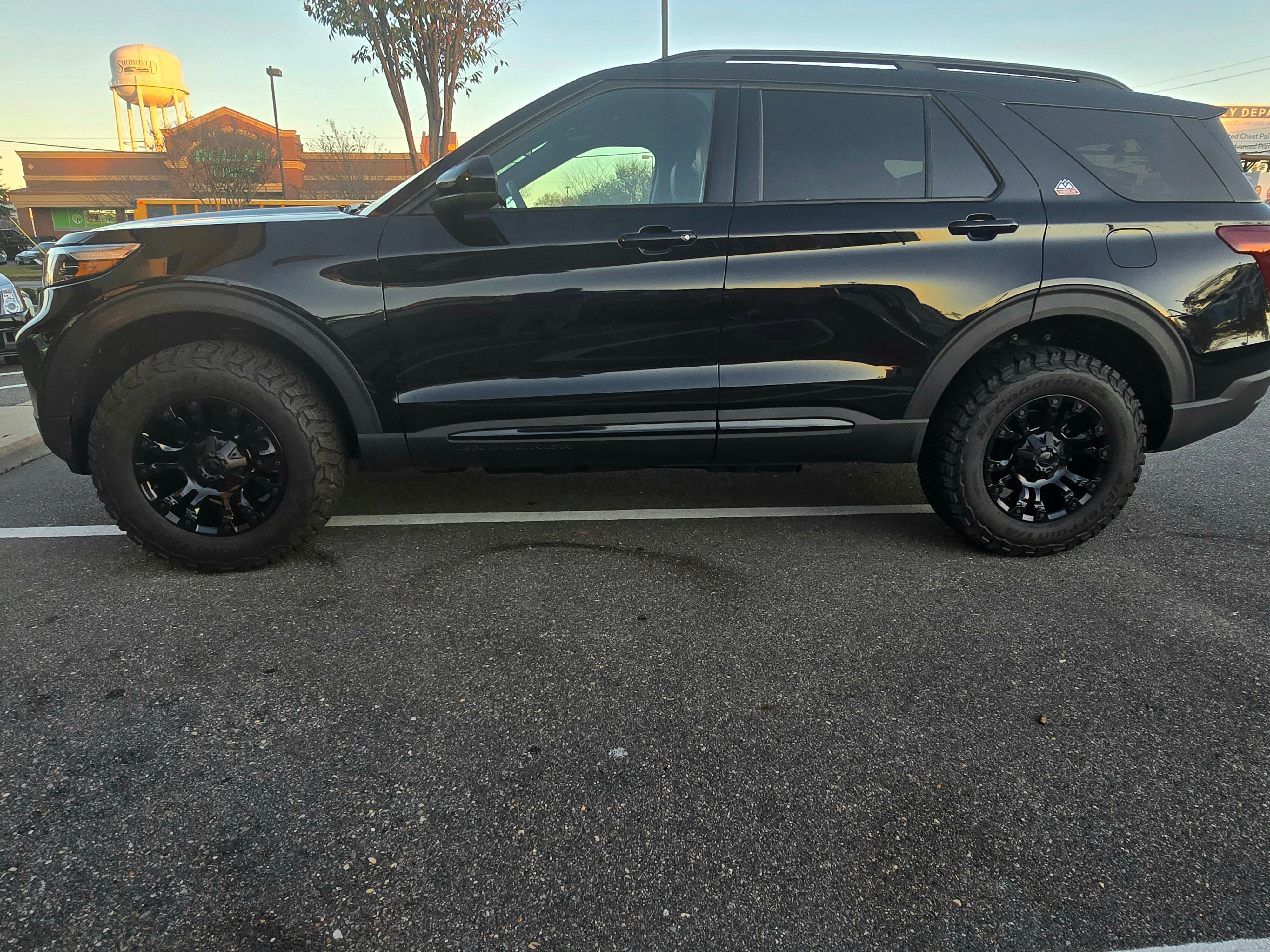

Dropped off my Timberline at the dealership today to get the work done. Also went to the tire shop and bought ko3 275/65r18 as that was what was recommended by the computer. I'll update once everything is finished and tires are on.
Here she is with a 2" lift and new tires. Went with ko3 @275/65r18 226 e rated tires.. a bit of trimming was needed of the liner on the rear.
It drives a little stiffer, but feels good and not too noisy.
View attachment 457475View attachment 457476View attachment 457477View attachment 457478View attachment 457479View attachment 457480
Can you share photos of where the trimming had to be done? I am considering this tire size for my 1.5" lift - factory rims and 30mm Mishimoto spacers.
