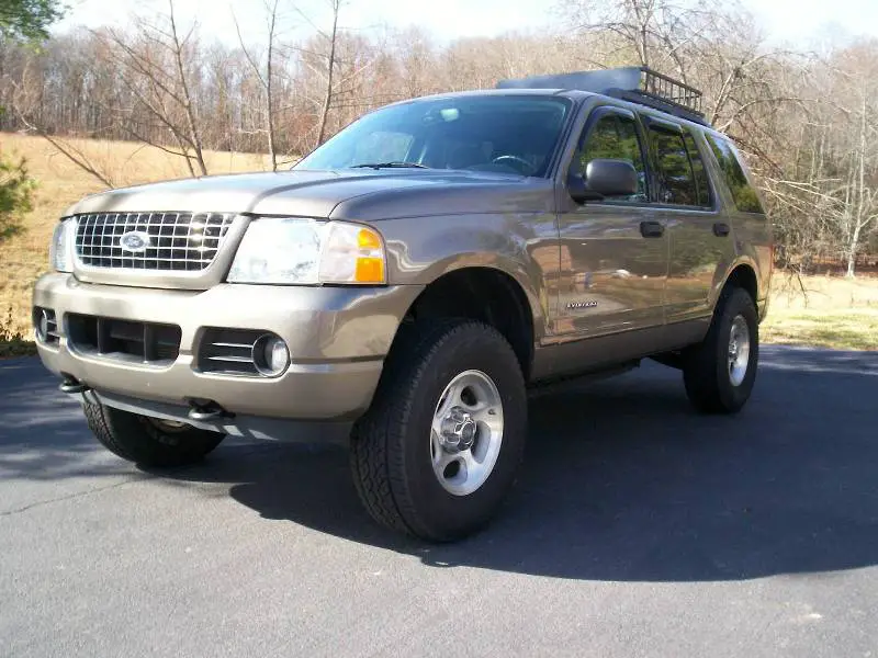

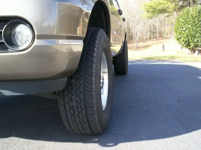

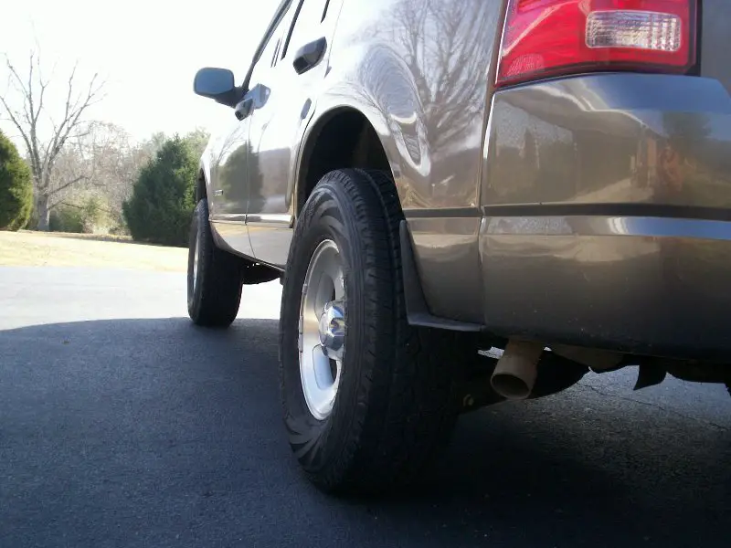

Here is my Ex with the 275/70/16's.

Goatman,
Like the look of those recovery eyes in the front bumper, where do they attach to? Where do you get them from?

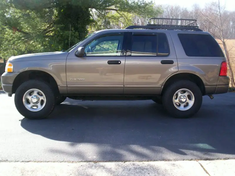

All pics are 265's, stock height, no spacers. Tires are mounted on 2001 Sport rims.

It looks like we had the same idea on wheels. Do your 2001 sport wheel have the same +12 offset as my Ranger wheels? Your tires sit at the edge of your wells very nicely. I like the tread on your tires. I went back and forth on tread design. I finally went with a quieter tread. We don't have the same potential for snow in Tennessee that you do in Canada.

Hey Nomad, Those tow hooks came off a F-150. They mount right up to the frame. If you search for F-150 tow hooks, you should find plenty of pics and instruction.

The rubbing isn't too bad at all, and it's only at full lock when you can't turn the wheel anymore. Unless off road, you don't turn the wheel that much in day to driving all that often. And I understand that with some strategically placed zip ties I can fix the rubbing. I just need to search for where exactly they go.

I'm not sure about offset. I bought the wheels from Donner for my Sport to replace my leaking 3 spoke steelies. The day the tires were mounted is the day I quit driving the 98. I didn't measure anything ( I know I should have ). I was going to sell the wheels/tires with the Sport but I just couldn't bring my self to do it. So, they now reside on my 05. And I love them!! As for noise, definately not as quiet as stock, but these Dick Cepeks are quite a bit smoother riding and FAR quieter than the BFG M/T's I had on my old Jeep.
