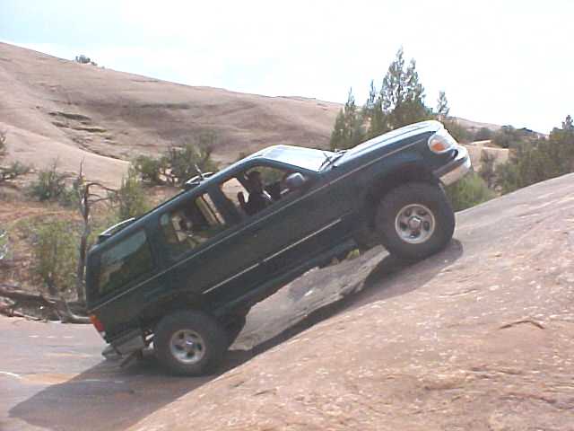

I got the 10.5s on the stock rims with a 2" BL, TT, and Shackle/AAL.
The only place mine rub is on the front pcs of tupperware. (I take them off for now when I'm wheelin and I'm going to remove them all together soon)
I have 3.73 and I've noticed a loss in power when climbing hills at higher speeds. (I can accept this until I can regear)
The increase in offroad ability between 33s and 31s is amazing.

That ranger looks tight.
