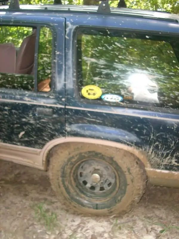

Here is mine on its maiden voyage, stuffing the rear tire...
I hope this helps you out. Don't let anyone fool you- it can be done.
Just because it can be done doesn't mean it should be done. That thing looks like it flexes about as well as my lowered street truck. Which isn't going to do much for you off road.
It outflexed all the mild Jeeps on the trail that day and certainly flexes better than an Explorer with stock springs and shocks. Body lift doesn't increase flex, so why push that over a suspension lift then argue that the suspension lift doesn't flex enough?
Is a real suspension lift better? Well yeah of course it is. The spacers and shackles you probably have aren't helping you any more than a body lift would though. And from the pics it looks like your stuffing the tires into the fenders before it had a chance to flex much. I reccomended (or "pushed" as you say) the body lift because it sounds like he didn't want to spend a whole lot of money, and a 4" suspension lift isn't cheap.
A perfect example why you shouldn't assume- I have 2" Skyjacker coils up front, Procomp shocks (cheap but ride great) for 2" lift up front, and ******* packed rear springs. Less than $300, plenty of flex, and I'm clearing 34s.
Speculate all you want on how badly it would "probably" limit me on the trails, but I'm done with the argument because I know for a fact it works better than I'd hoped ON THE TRAILS.
Well if it works for you then that's great, but I don't think a lot of people would be willing to butcher their rigs like that, especially in the rust belt.
