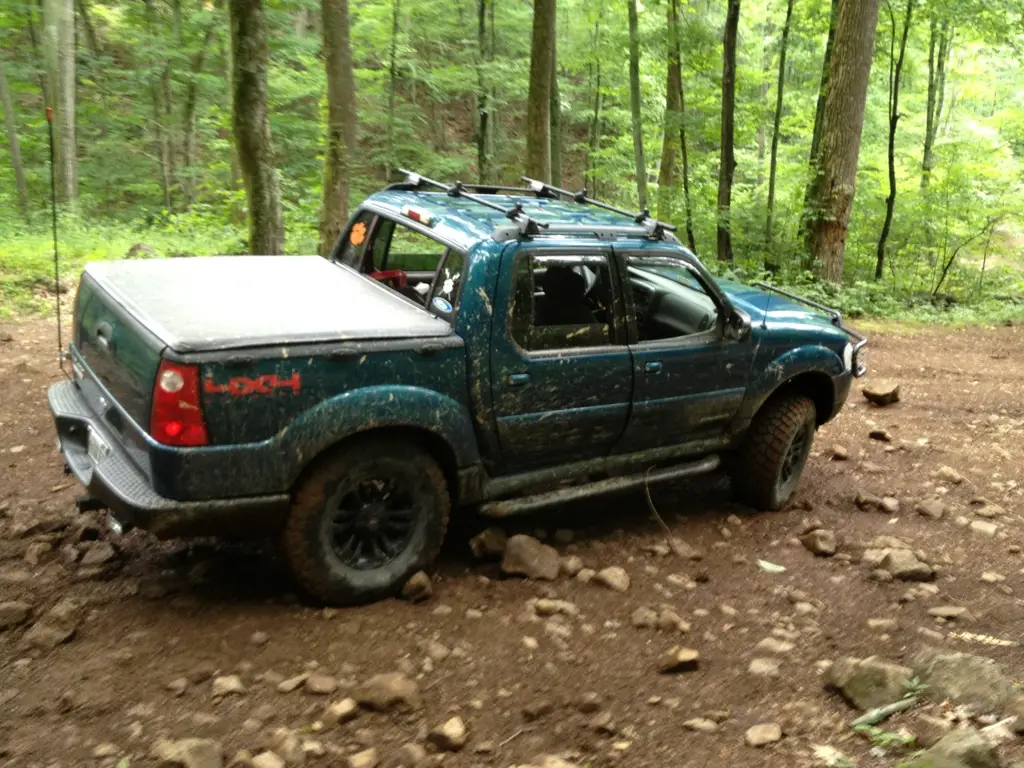

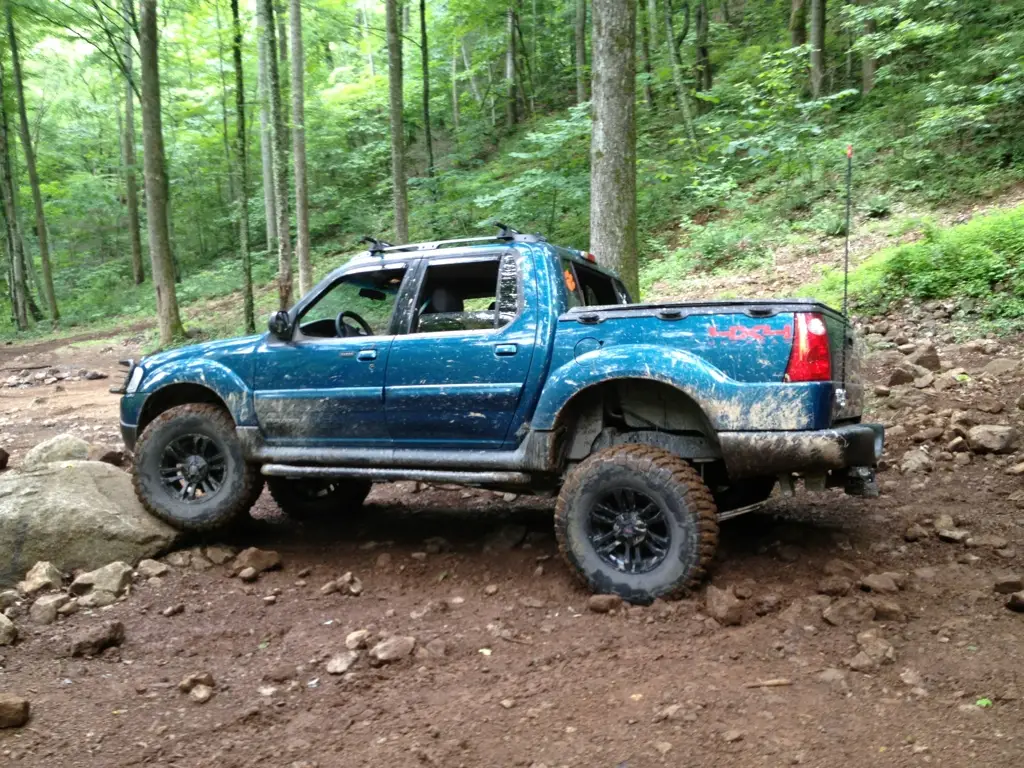

Got some flex pics the last few days. Ive been up on 3 wheels on all different corners and I haven't had to cut any extra than the 1st week. Just follow the trimming pictures in this thread and that'll allow movement all around.
No real closeups but the right rear is almost at the bump stop and the left has no weight.
Great to have another person confirm that you can indeed fit 35s without rubbing, no outer cosmetic trimming and certainly not having to trim off the whole front bumper. I don't feel that many believed I truly don't have any rubbing. Our wheel wells are enormous and if you get the right backspacing on the wheels, it's not difficult. So, to all the nonbelievers,:p:.

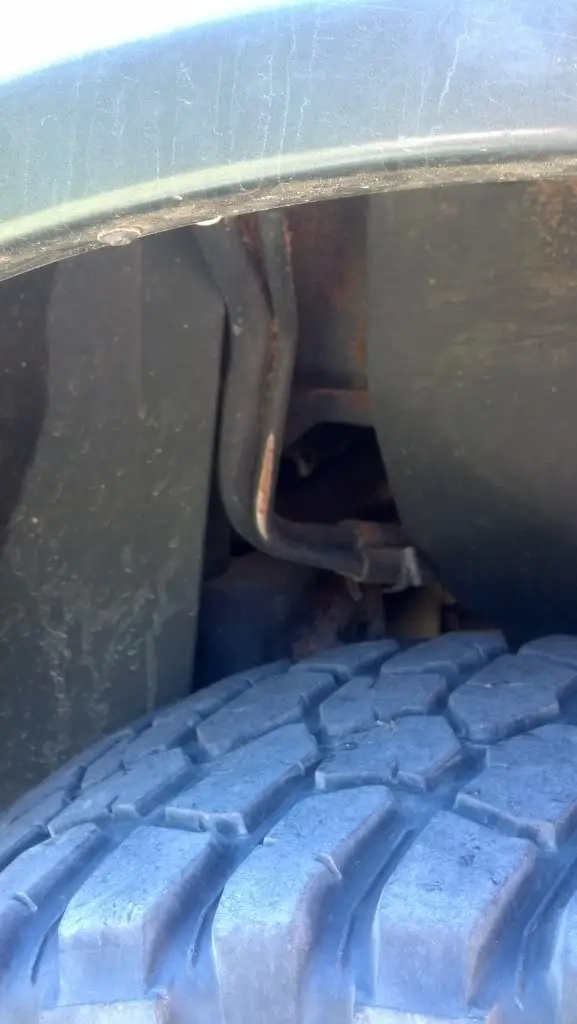

Probably should update with this as well since I just realized this a couple days ago and snapped a picture:
Gonna have to look into this.
I just noticed that last Thursday washing it off. I think taking the sway bars off let the tire flex into the line. Does someone make flexible fuel lines that can be routed more toward the middle of the truck?
