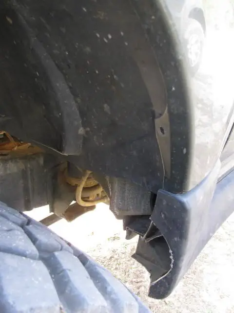

Trimming:
Driver's side
There's an angled piece of metal right behind the wheel well that looks like a brace of some sort. Did you change that angle or just cut a piece of it. I can't really tell from this pic.

Trimming:
Driver's side
imageremoved[/IMG.]
There's an angled piece of metal right behind the wheel well that looks like a brace of some sort. Did you change that angle or just cut a piece of it. I can't really tell from this pic.[/QUOTE]
If it's what I think you're talking about, I cut it. I really only used the hammer to dull and flatten the sharp cut. Fell in love with the sawzall during this project.:sawzall:
