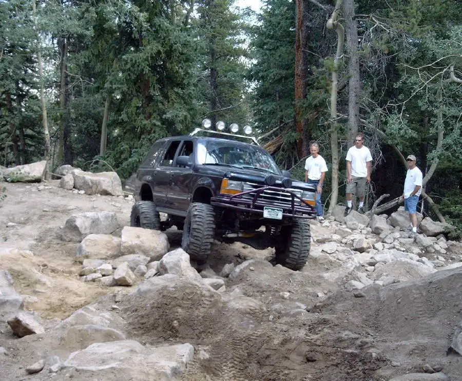

Here's my 94 with 35's. 4:88 gears (should have waited for the 5:13's) makes it close to stock-ish, 7" of lift (4" suspension-3" BL) and slight front fender trimming....

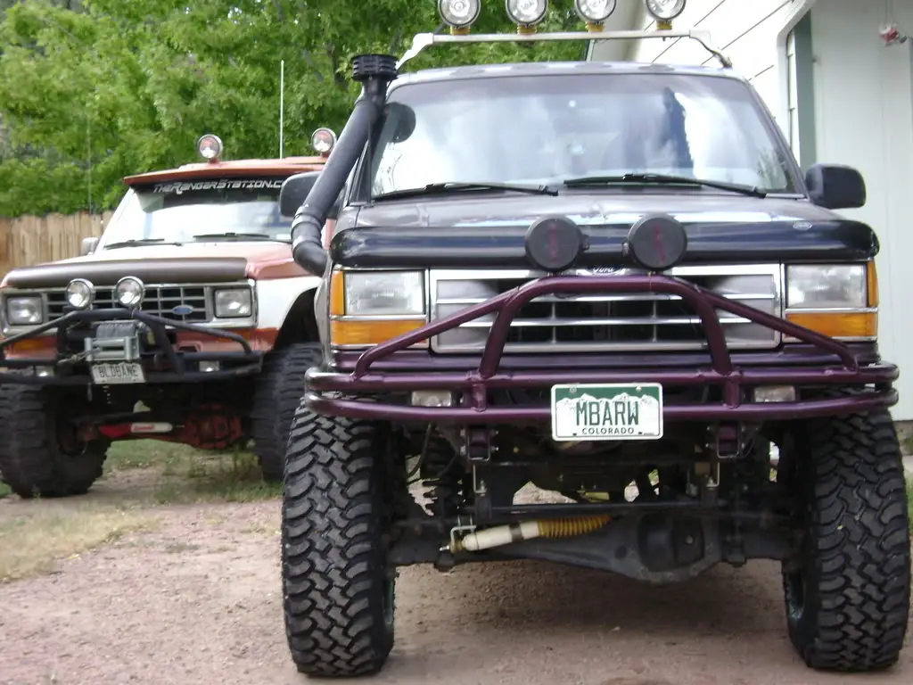

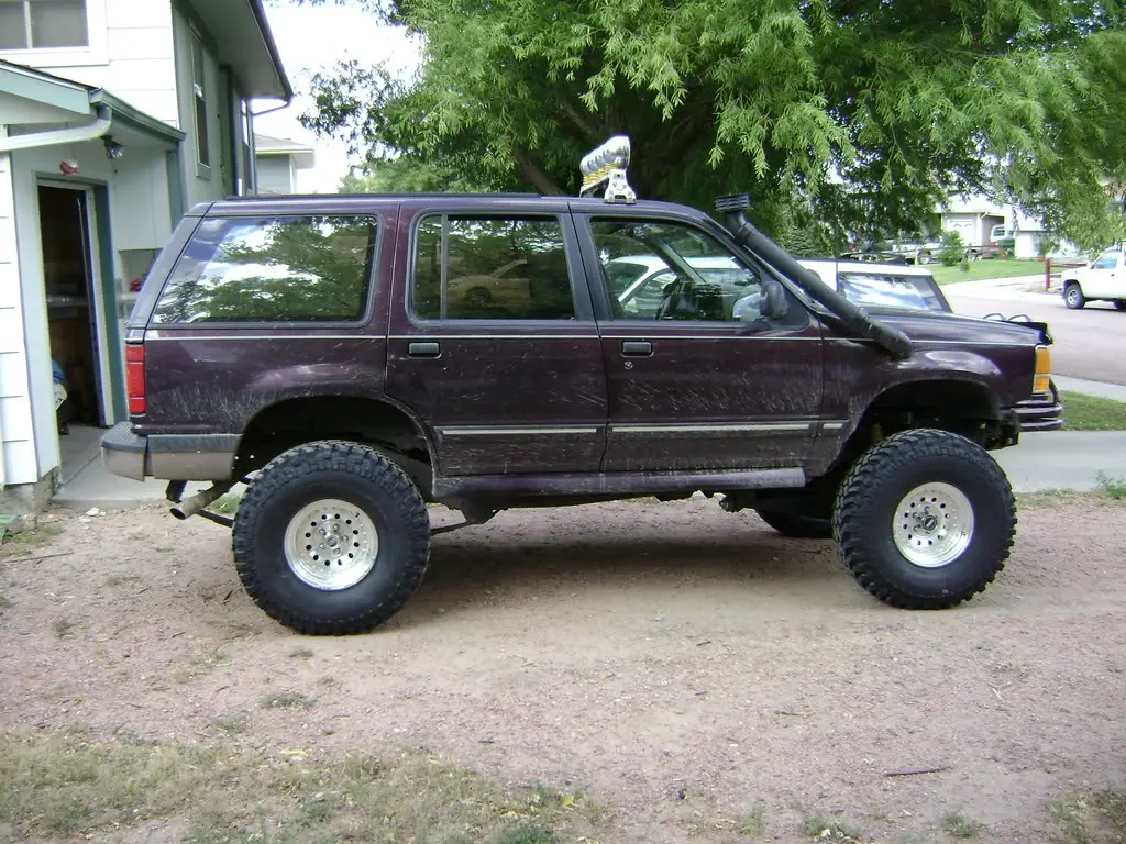

Every truck is different and every tire/rim combo is different .i would say the hole bottom corner and some of the body/fender mounts.if you look at the pics posted you can see how much they have trimmed and they have more than 6" of lift.im sure you can make them fit but if you wheel it hard they may rub with trimming.i can tell you with 5.5 lift and 33x12.50 i trimmed to the point of not being able to trim and they still rubbed.i run 9" of lift with fiberglass fenders and my 36x14.50 come VERY close to rubbing

FWIW. On my '94 (6" skyjacker, 35x14.5x15 Thornbirds) I had about 1/4" clearance between the tire and corner of the fender. The lift was pulled off my Ranger and swapped onto the Ex, so the springs were already broken in. I couldnt turn the tires at all. I cut almost 3" out of the fender and rolled about 3/4" back to form a new lip. I can still get them to rub, if I so desire.
