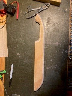

My biggest wish is front armrests/door pulls. I think it would need a pretty good size printer, or maybe make interlocking parts? It's on my list if I ever get a printer.
I'm pretty good at designing and printing parts, but I ended up just cutting a new armrest out of 3/4 inch hardwood plywood I had lying around. It took about 2 hours start to finish. It would have taken much more than that to design and print this part and would have used probably close to a roll of filament. I ended up just pulling off the existing remnants of the armrest, tracing it out on the wood and cutting. Sometimes it's best just to grab the jigsaw...
