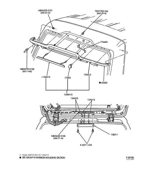

If there are no visible screws on the outside there should be 2-3 nuts on the inside of the liftgate behind the molding where the brake like is.
Yeah, that instructable is for a neon version, hence the electrical danger, mine's LED. So I will also require the same access from the back, the drilling out the rivets and all that?
Rear access is required. Drilling may be required. new light bolts in
Yes the whole assemly have to come out, rivets and so on.
If you have a LED strip inside, someone changed that before from neon to led,
the ballast for the neon - stick have problems and not available anymore.

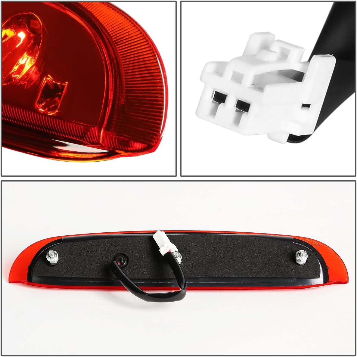

yes, that's the neon version though, mine's the LED. There's no balast (that silver box with the "high voltage danger") for an LED and the light assembly itself (the red plastic part) is about half the length. I cannot find any diagrams or videos of how to replace the LED version. On the 2002 on up there are exterior bolts to the red plastic, I don't have those. I'm just going to tear into the backside of the door as if it was the neon and see where I get to. Maybe I'll take pictures and post them here. There goes my Saturday :-)
Good news, Fixed! 10 minutes tops. You need access from the back but you only need to pop out the tabs on the top and sides to the trim. Trim does not need to come off the door. The tabs are not like the '95-'99 and there's nothing to pop off from the outside, you just lever the trim perpendicularly away from the door, there's one tab on the left and right of the light and one on each side about 12" down from the top. Then, no rivets! There is a piece of wide electrical tape on the door panel (!) you pull it back to reveal holes in the panel exposing the three small bolts holding the light in.
