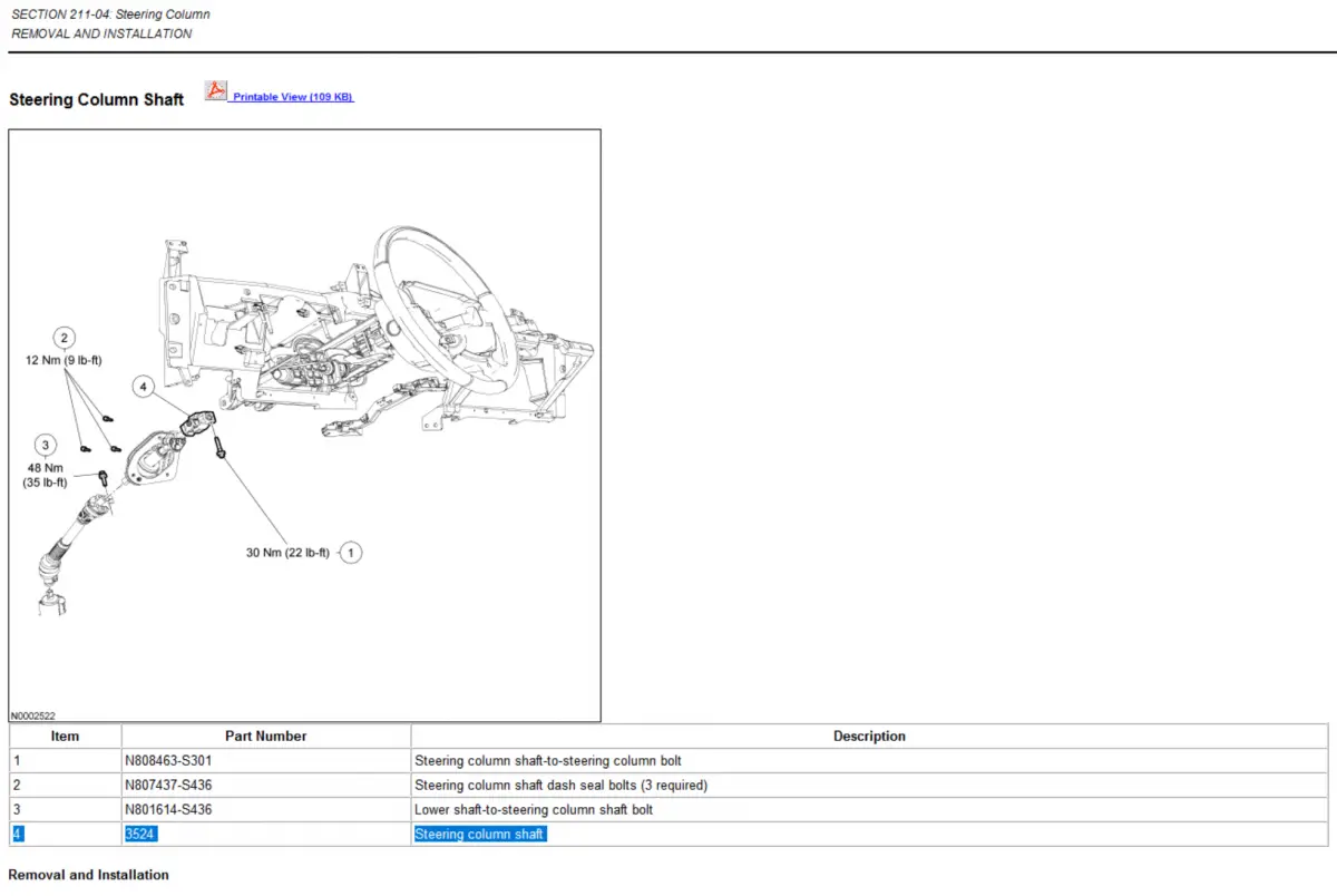

My Explorer 2005 is 96K mi right now. I adjusted the steering wheel height a month ago, since then I noticed the steering wheel started showing some play, as in the video.
I changed my tires just after that, did the alignment and replaced the front upper ball joints. So, I know that there is no play at the steering and front ends. One of the tie rod end was replaced 7k miles ago.
I few no difference when making turns, thus I guessed it should be the steering wheel bolt.

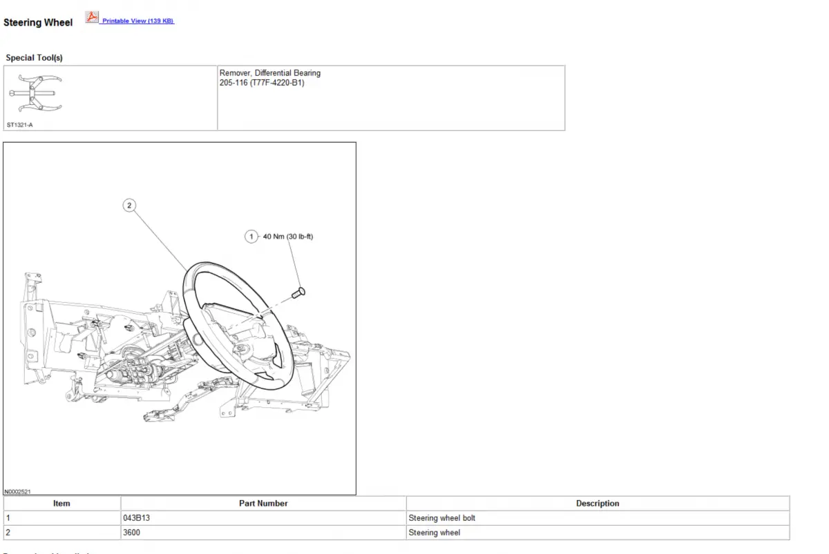

I removed the steering wheel cover and tried to tighten the bolt a little bit without forcing it, but it looked like it was not the bolt. As I did it very, very softly without applying too much pressure, I am not sure anymore. It looks, however, that the looseness comes from beyond the bold.
I have an old Ford workshop manual for that vehicle. After analyzing the manual, I started to think about the steering linkage. But there is not much information there about how to solve the problem.
Do you have any idea what is the root of the problem?
