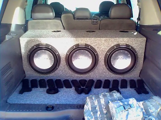

heres my 3rd row delete
i like how clean yours looks thats a really clean job. did you have any issues with raised sections where the seat belts mount
If your seats are grey cloth, I'd buy them.
that fiberglassed rear is sick did you do it yourself or no? i was gonna glass mine but i do some spl comps so the ported setup is better for me. plus i still have my shovel, jack, tow strap, hand winch, wood and other toys under the sub floor. i made mine to flip up into different compartments.
Yep did it all my self with my brother. i have a post in the a/v section with all the pics from start to now. I will be doing some shows/comps with mine . i havent metered it yet but im sure it wil be decent after i break in the new sub and get everything tuned. and i agree ported is better but i have always wanted a (pretty box) lol.

its amazing some of the work you see on here. i have glassed a few boxes but thats too much work for me unless im getting payed haha. my box took me about 6 hours to build/carpet with no one helping, over night sealing/curing time and about an hour of wiring. my dam subs have 16 allen screws per sub what a pain.
