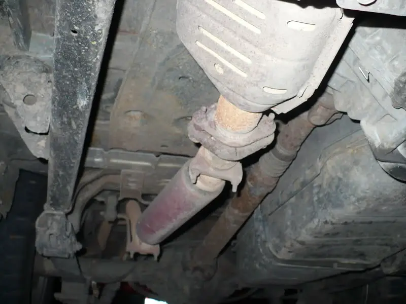

Here's a pic of the cherry bomb. It's been on my truck for a year. I just took a sawzall to pipe right next to the front and back of the muffler and then got some adapters and clamps. it's not pretty, but it works.
yes it is angled. then ends of the cherry bomb are angled so it would fit where an offset muffler was.
