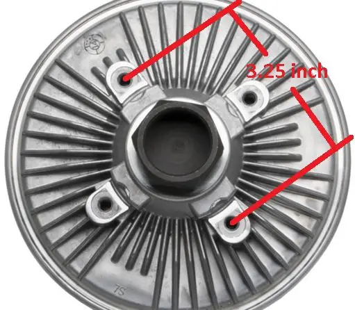

Can someone help me with the bolt hole measurements from a 4.0 or the bolt holes on an old clutch from one
97 4.0 sohc, hope this is what you need? Bolt thread M6.

It is shameful and embarrassing that a man from another country had to be the one kind enough to take time to give me the tiny info about an american vehicle. THANK YOU AGAIN FOR YOUR KINDNESS if you ever need a hard to find part from over here please message me
I love American cars, esspecially our 97 Explorer, so it is no shame, for me it is a matter of course.
Have a complete spare engine on a table with attached fan and clutch. Little thing to measure
the bolt circle.
