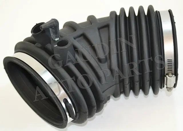

My objective in using the Lightning air inlet is to avoid fabricating an intake tube from a 2002 Explorer air filter enclosure to a Mach 1 throttle body.
It has the correct general shape but don't know if it will clamp on to the throttle body.

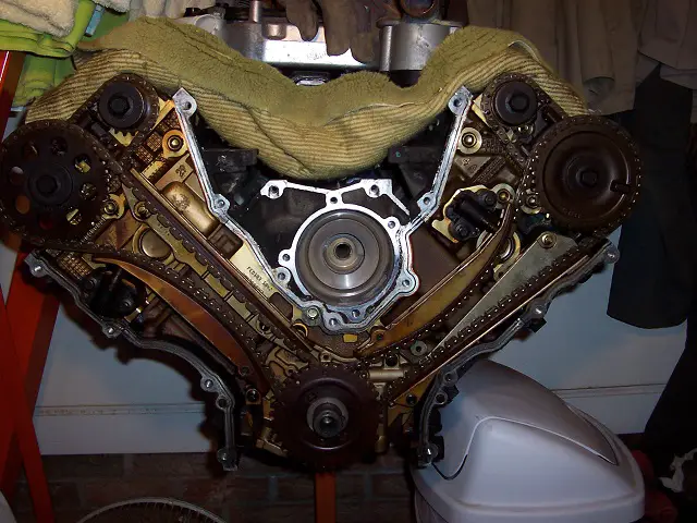

Didn't get as far as I wanted today on this, had a heck of a time getting the RT valve cover off with the hard AC lines taking up space at firewall. Loosened the hard lines mount at the fender well and was able to force it out with out damaging anything . May need another trick to get it back on with the gasket intact.
I was able to feel an extremely loose chain RT side and a large hunk of the fixed upper guide that is all plastic. (not like the metal backed one in Pontisteve's pictures of his motor) the laying on the chain. It seems to be big enough to just float around in there 3-4 inches long or so est, tried to grab it and pull it out but its got some obstructions on both ends maybe better it did ... UG to think I was driving it earlier today that way.
Next challenges to pull the PWR steering pump back (hoping I don't need to pull the pulley but might) and get the Harmonic balancer off, get that timing cover off and see whats up.
The passenger valve cover is easier to remove if you remove the coils first.
The PS pulley must come off. Note, the removal tool scoured the pulley mounting surface on mine during removal and it would not go back on. New pulley was cheap.
To remove the pump, you do not need to undo the lines or drain any fluid. First remove the two bolts that have clear access. Then loosen the bolt that is blocked by the PS hose. Once this bolt is loose, hold the PS pump by hand (keeping its weight off the bolt) and you can use your fingers to continue loosing this bolt. Just keep moving the pump away from the engine and the PS line will never be in the way.
When your putting the chain guides back, before you mount the new tensioners, make sure you have the same amount of chain links between the timing marks on the crank and cam pulley on both sides of the chain.

(Right side was our target side since it was rattling) My Mechanic buddy helped me pin point the noise using a long 3 ft screwdriver. Press against spots on the block, heads and timing cover with ear to the other end. It was very evident the noise was from the Rt timing cover, louder just below the cam sprocket.
This all looks about like I saw in the first post only guides not as broken. Even the pulse disk markings and inside of timing cover chain had similar marks indicating the chain was bouncing all around, but had not jumped timing based on chain link counts (and it seemed to run good). Also interesting to note the darker color on insides of RT side timing cover and cam area on the head. Ours looked the same, Rt side darker in color, Lt side very clean looking. Not sure if it was the way that RT bank was running with the cracked guides affecting timing or some oil starvation on that side. Or the way the chains may sling oil due to the motors rotation, (CW facing the front of the motor). The LT side was much cleaner inside looking not tinted brown/ black at all. But all the timing wear was near identical only somewhat more on RT bank.
RT, Upper fixed guide in 2 pieces both mounts for it broken so they were both loose and floating laying mainly on the the chain but large to be trapped from moving to far in directions of chain.

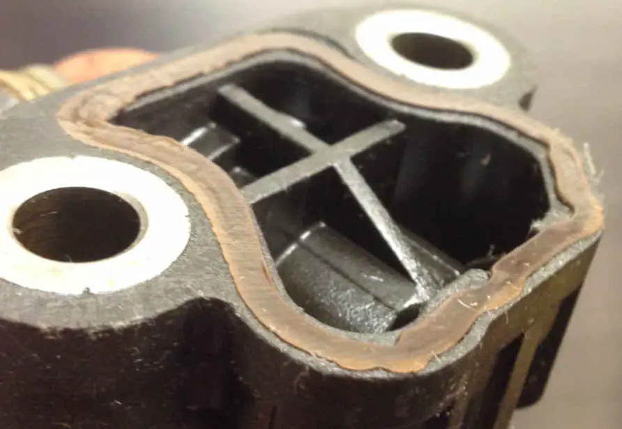

RT tensioner Worn through to piston, Piston was NOT collapsible seems seized in full Up position. Found seal failure on backside mounting due to warped surface allowing the soft urethane/silicone like seal to give way.

Also compared and used the earlier tensioners, ran a very thin smear of Permatex #2 (not silicone but sticky brown black case sealant) on the sealing face may not be necessary since both surfaces are machined flat.
