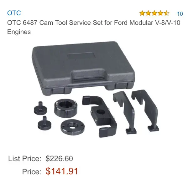

The OTC 6487 is the whole kit for 2v motors. Check it out. It has a few different tools I'm not used to seeing in the 4v engines, so maybe I'm missing something. Usually the cam holding tool is the most important, unless you're timing the cams from scratch.
All that's needed for the 4.6 is the two items are the far right which span the head and the two at the far left which go into the cam.
I was of the impression that this went at the front of the engine, but in another thread here, I saw them in place at the back.
When I contacted OTC, they said these did not fit the Explorer 4.6 2002-2004.
I didn't even check fitment at the back of the head.

No Pics on how OTC 6487 Cam tool is installed?
If you go to OTC's website, that kit says it fits the 4.6 from '92-2012. However, when you look at each component on their website, or call their Techline, they'll say it doesn't fit the 4.6 after 1998. Same with the packaging.
I bought the 6020 and 6009 but wasn't able to use them.
After completing my timing, I saw a post somewhere and the tools I'd purchased were in place at the back of the cams. Give it a try and update this thread. Did you pick up part number 6024? Crank holding tool. It's worth having it.
Can't find any of the tools in my area to rent. This is going down this weekend, so I'll just press on
