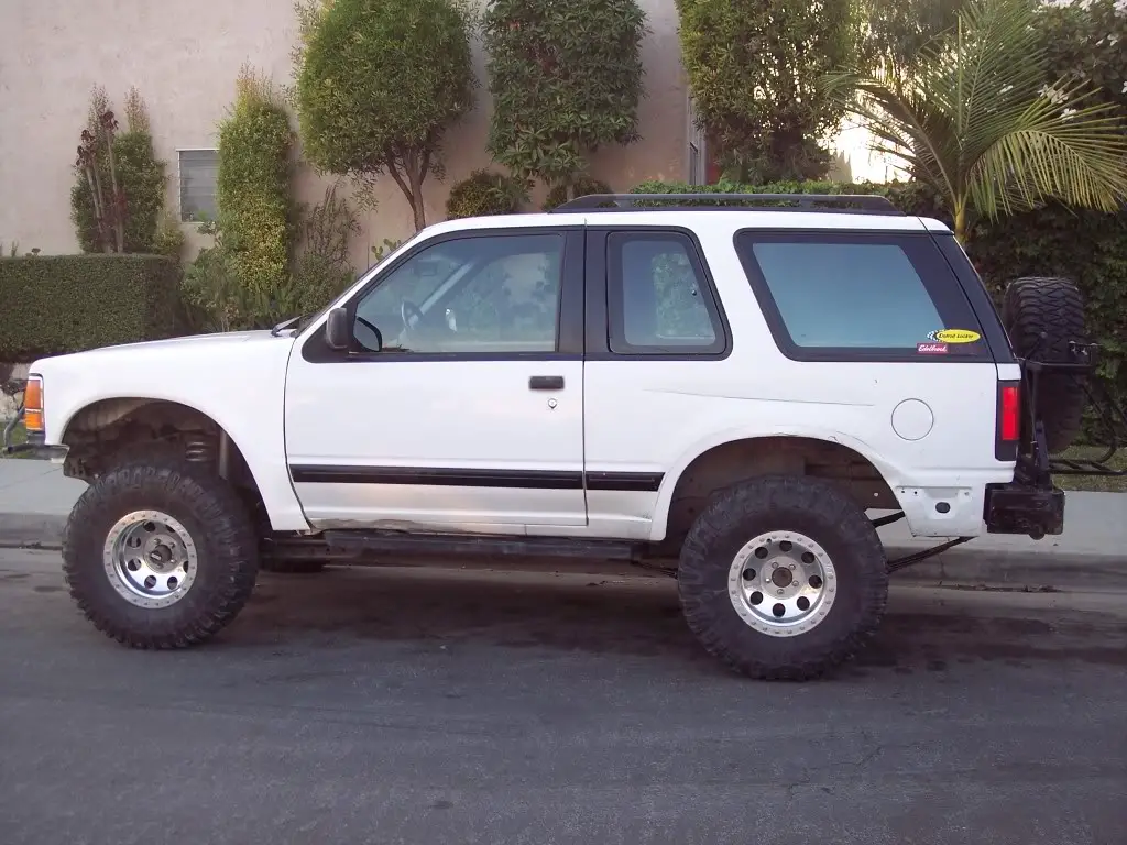

nope, look at my pictures on the first page. 4 leafs

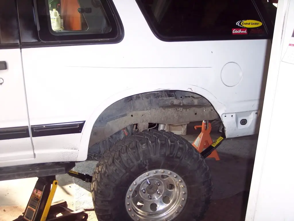

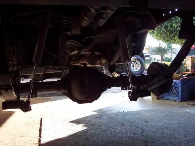

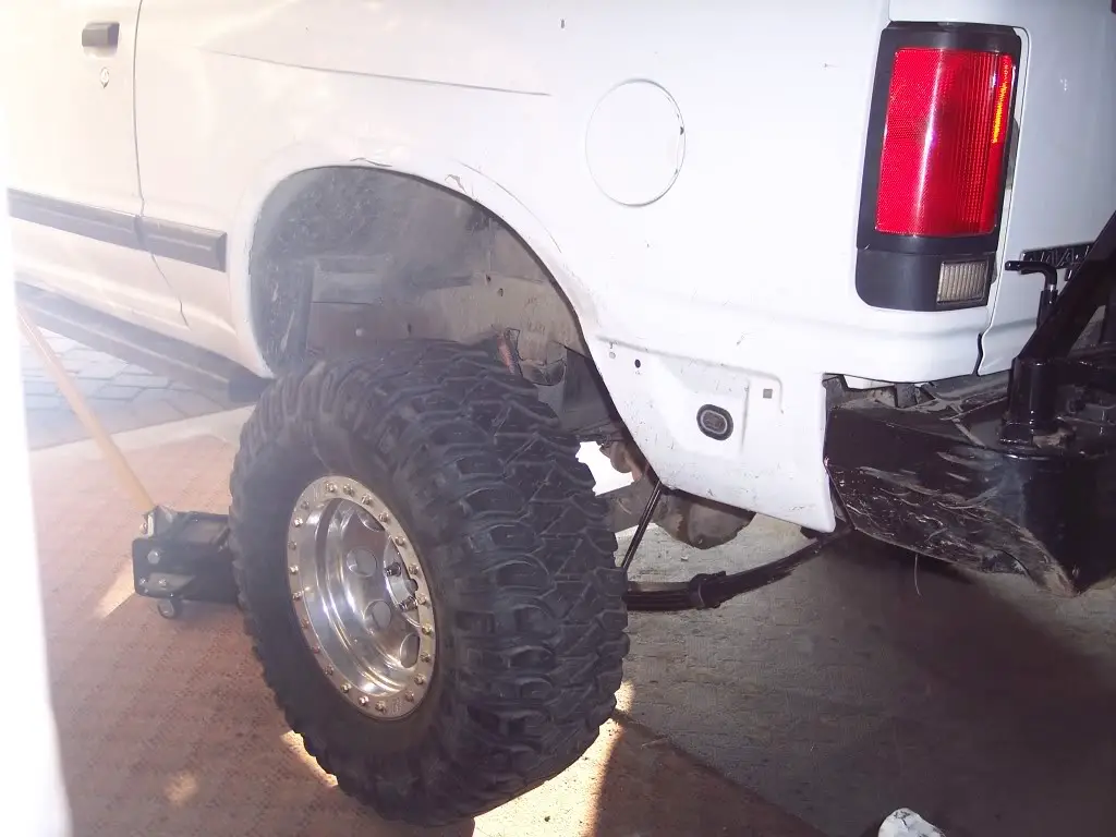

got it together today. just a simple replace of the same springs, but brand new. gave me about another 2 inches of drop travel and rasied the back end up a bit. i assume the springs will settle in and sag down maybe an inch.

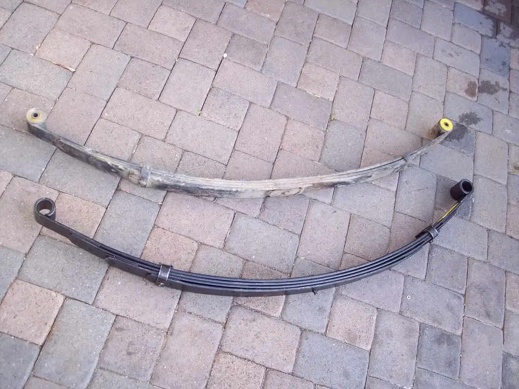

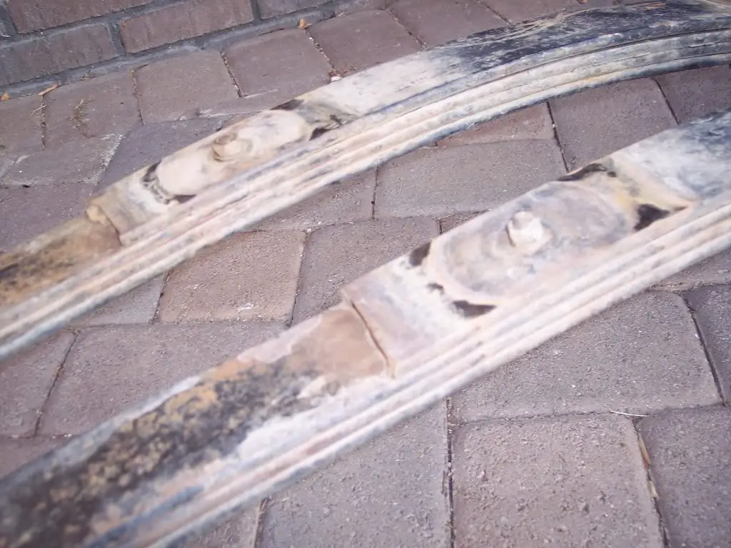

old springs and new springs
and i found out i actually did break my old springs. half of the bottum leaf must have snapped off. i thought they looked kinda odd :rolleyes:

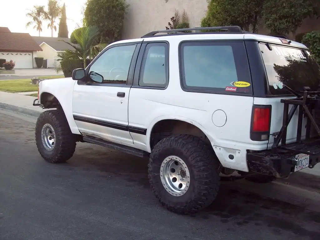

everything pretty much back together
full drop :rolleyes:

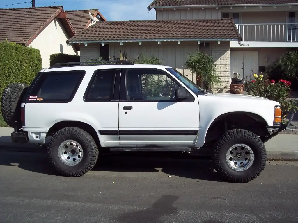

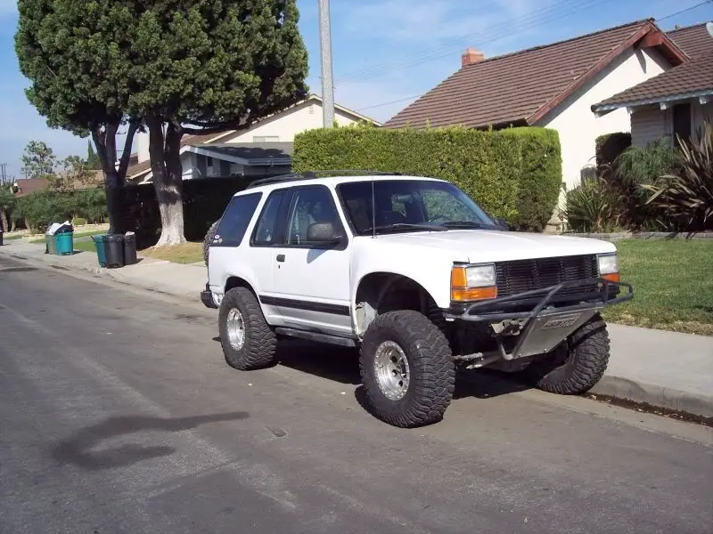

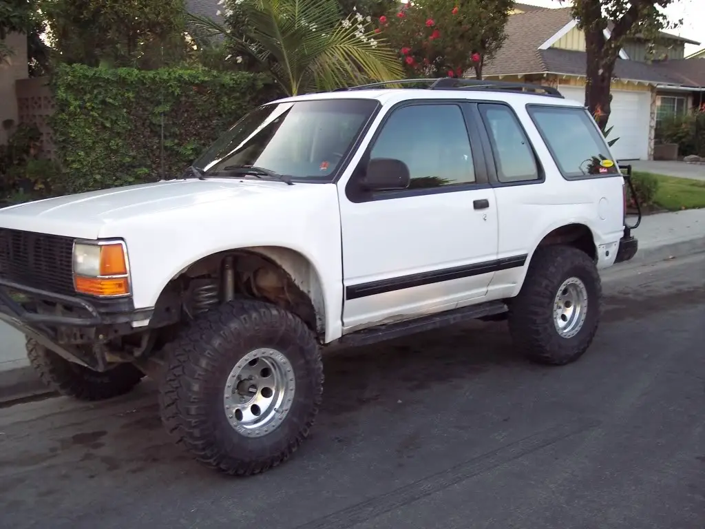

and some before and after shots
before
after
i could probably bend out the clips on the spring for more drop like maniak said, but im at the end of my shocks right now. i plan on doing that and installing longer shackles after truckhaven, but i'll have to reareange my shocks more like the way dannyboy has them
i guess we'll never know what happens when you put an add-a-leaf in 4" lift springs
Well it looks a lot better and i'm sure it will perform much better too.
