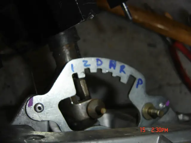

in my 88 Bronco II I have a 97 4r70w from an Explorer.
I am using a floor shifter from a 96 Mustang which includes the O/D button in the handle.
I also filed down some detents into the stock shifter so when off roading I cna force it to stay in 1 or 2 (stock it just slips right to drive)
in order to convert the 4r70w to work with the mustang shifter I needed:
96 mustang shifter pawl (shift lever that goes through the trans case), $20 from Ford better then laying in ATF at the junk yard
the 96 floor shifter (obviously, local Mustang parts place, $60 complete, also on Ebay for CHEAP, make sure you get the cable, it will have the bracket that bolts to the transmission on it, they are one piece)
This setup works 100%, its flawless, its factory parts, and it clears my front driveshaft
I have pictures in my BII registry thread in my signature....towards the end I just finished this mod last week.
I did not want a column shifter, so the Mustang shifter was a natural fit.
