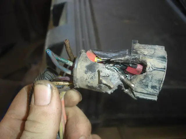

take the motor off, its 3 or 4 10mm bolts, remove them and pop the motor off. behind it is a lever and you will see positions marked 2wd, 4hi and 4lo. use a pliers to turn it where desired (make sure its in neutral for 4hi or lo)
I had to do this sunday when my wiring harness at the t-case took a shot from a stump and I couldnt engage or disengage the t-case.
