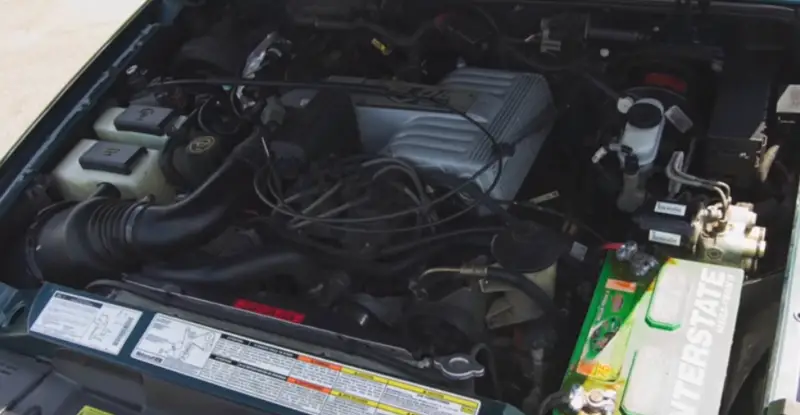

Hey Joe thanks for chiming in! She looks awesome!!
What intake elbow is that? (The plastic air hose from MAS to intake)
Who's coil packs? MSD?
The Ranchero looks awesome!!
Jamie,
The coils are Ultra-Power, which were a premium level component I purchased on RockAuto...I do see an Ultra-Power coil on Rock Auto but it looks like a standard replacement. The coils I have are suppose to be "better"...but who knows, they were like $35 each.
The elbow is Ford Part #: F67X-9R504-AA google seems to think it is from an Explorer, but I can't remember what year etc...
Stay warm up North :-)
Jamie,
Looks like the elbow is from a 1997 v8 Explorer...I just ditched the two flexible rubber ends...
