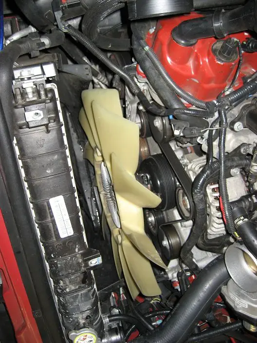

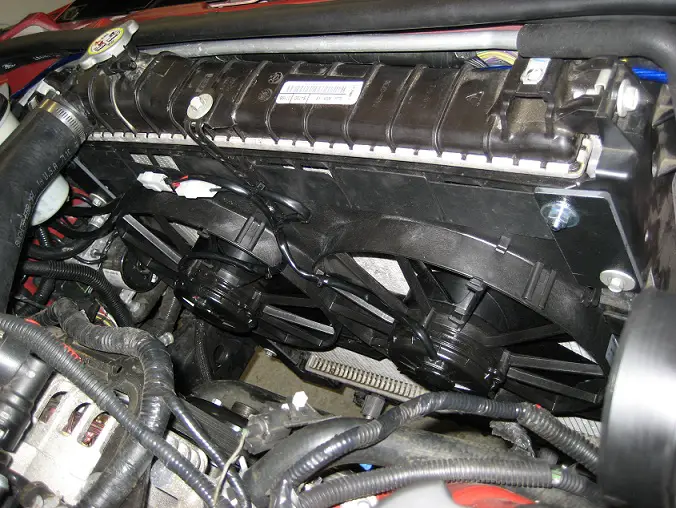

Got the dual electric fan conversion completed today in preparation for the 5.0 motor. No more clunky mechanical fan! And hopefully frees up some hp. It reads off its own temperature sensor that fits in the stock block's coolant plug hole.
Ignore the dirtiness, the engine is coming out soon, so I haven't bothered cleaning it up.
Radiator was a PITA to remove though. Glad that's over with. Whew.
First pic is old fan setup.

What fan setup is that? Does it sit flush to the radiator? I would be concerned with how many of the air paths seem to be blocked by the "flat" area of the shroud, but hard to tell from photo.

It looks like the flat areas of the shroud are rubber flaps. They would open when there is enough airflow.
