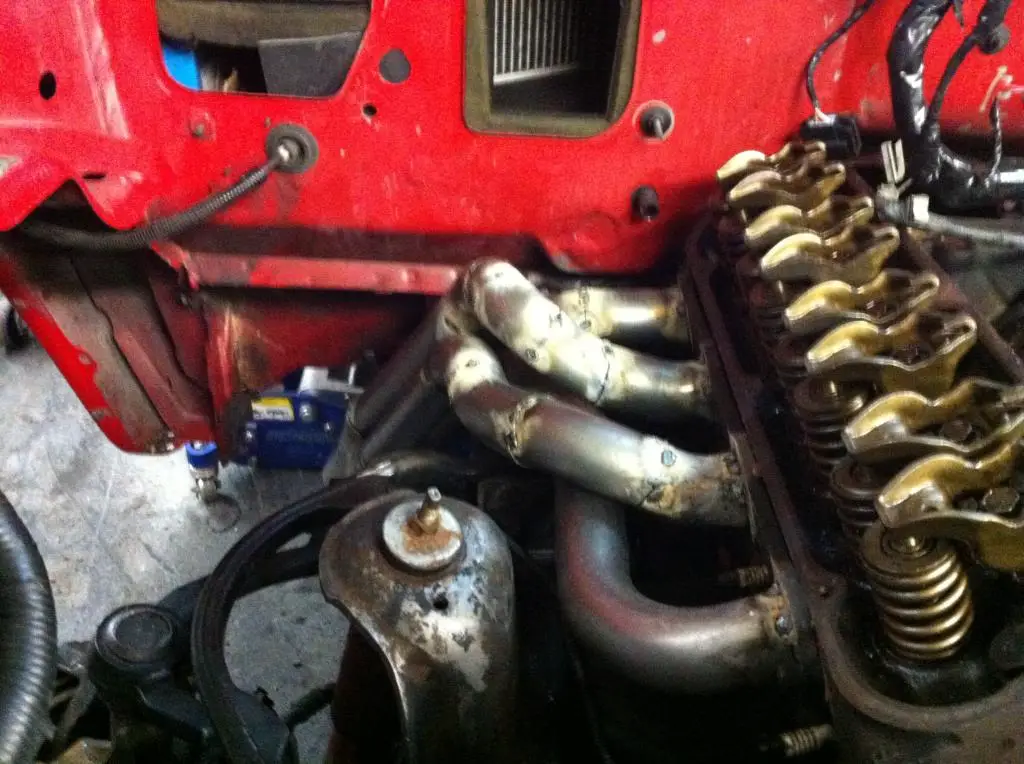

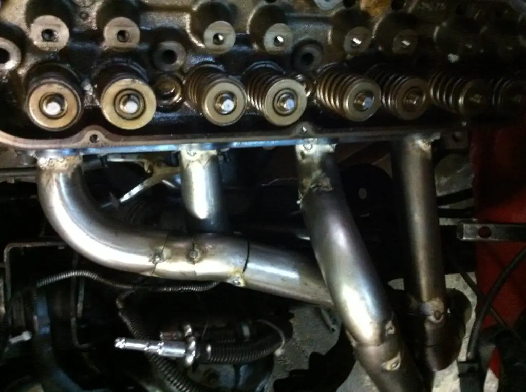

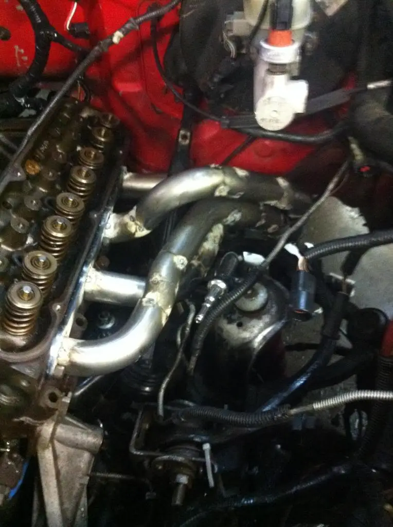

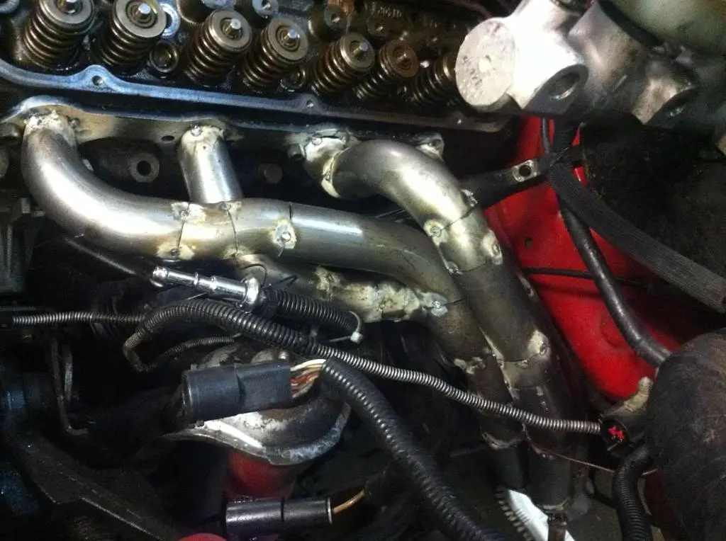

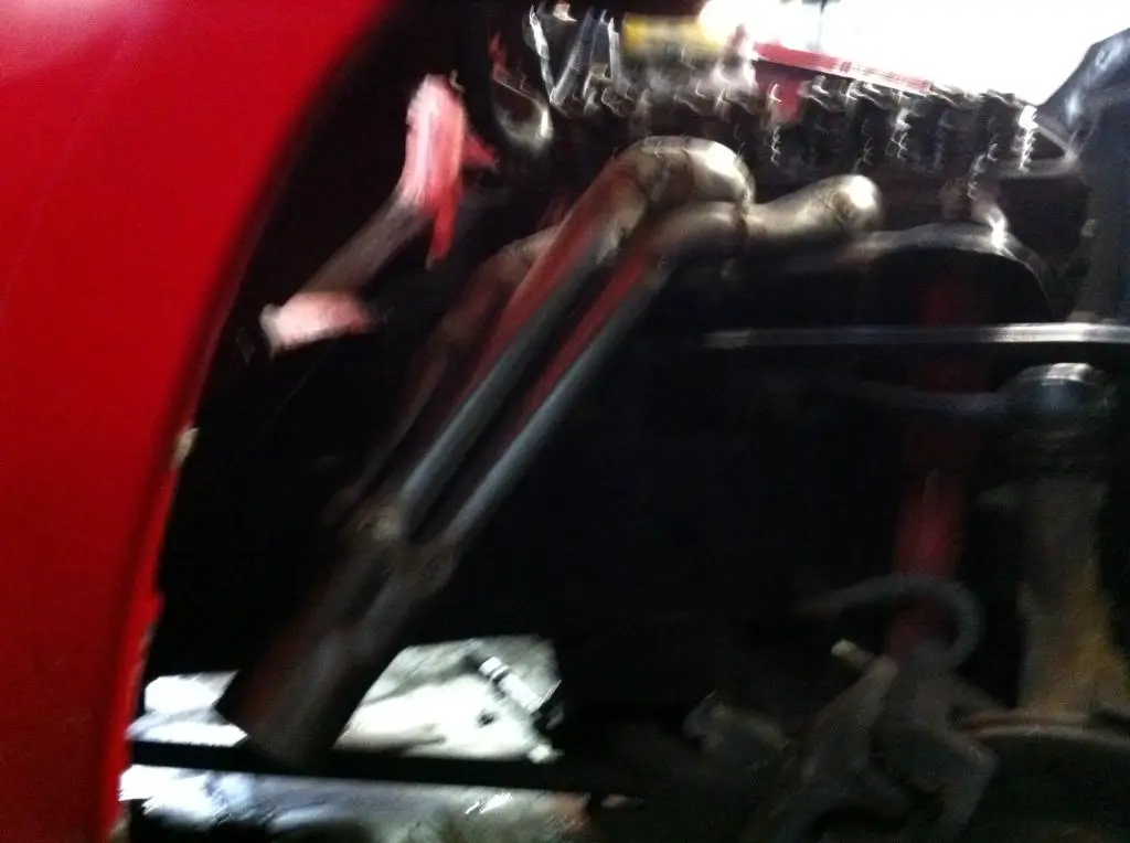

For your other consideration you are talking to, you CAN make it between the frame with a pipe of the size the OP is using, but you have to get creative with the pipe, which means you may have to re-shape it a little. In other words, you oval it out a bit. A 3 inch body lift would give you another half inch or so of clearance though, so you may be able to fit the pipe through without a problem. Even without the lift, this size of a collector might squeeze through, but I would worry about interference problems without solid motor mounts. Another possibility, since long tube headers aren't going to line up with factory exhaust anyway is just to run the primaries down between the frame and put your collectors much further back, but then you will have to lift the engine to install and uninstall them. This, however, is not that uncommon a thing to have to do for anyone who has put headers in an old muscle car.
