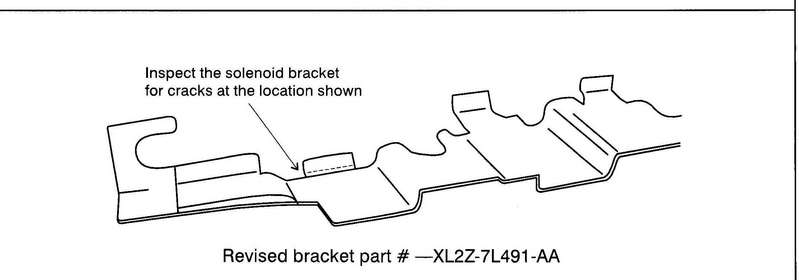

I'll try that. What colors are the wires? Also what is the part number for the updated bracket?
Take a look at the 5R55E valve body rebuild thread for color code information. Here's a picture from Glacier991's photo gallery of the updated bracket:
