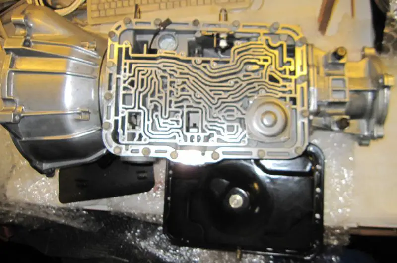

Long time ago, but i have to rebuild my Dana35 font axle.
The transmission is reassembled to it's specs, everything went fine.
Now the tranny is ready to get its brain (VB) back.
Thought by myself, it couldn't be so bad to order some shift kits (use the upgraded rings of the transgo kit, use the red clutch springs of the superior kit).
Got these three of them, but now (after talking to some tranny guy's) I think I should not mix them?
I am sure that have read all posts of the 4/5R55, but i didn't found something about that.
The valvebody seems to be in good condition and it looks like original without any upgrades or drilled holes.
Seperator plate seems original too?
Reading the shift kit manuals, the manufactors follow different intentions.
The sonnax zip kit, I like that best, it's my favorite.
Any good advice?
Wolfgang
