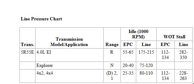

Results and specs
So I don't know if I trust the specs since they say
Trans 5R55E
4.0L EI
Ranger
4X2,4X4
This is from Ford's workshop manual on their official website in which you have to have passwords etc to access. It is supposed to be updated where old books or disks are not. Also I was under 1998 Explorer, not Ranger. Got to love the discrepancy's. This is why I don't trust the specs.
If EPC pressure is out of spec is has you go to Pinpoint test E which is entirely on circuit diagnostics of the EPC solenoid like opens and shorts etc. Of course there are no electrical problems with the epc so that is just a dead end. Then they say if EPC operation is OK go to Line Pressure Chart. lol.
EDIT
OK I found the problem with the specs. The workshop manual has ranger specs in it where the procedures are.
You have to go to specifications at the top of the section to find the specs on the Explorer. They do that so they can use the same procedure for all the 5R55E's that year and have to just put something in the procedure. I did post the Explorer one earlier.

Results again
So according to the supposedly correct specs now....
EPC Pressure as measured by NGS scan Tool.
D,2, and 1 EPC pressures are too high at Idle. At stall they are all good.
I should hook up pressure gauge to see if it and the NGS correspond.
Also I just noticed that the specs say Idle(1000rpm). I was at Idle 650rpm. Love it!
Line Pressure as measured by gauge.
D and 1 Line Pressures are high at Idle, 2 is right at borderline high spec 110.
At Stall D,2, and 1 are low. 255 compared to spec of 228. A whopping 3 psi too low. ???? Might be the gauge.
I assume some of the pressures may be different because this is an upgraded or modified Valve Body.

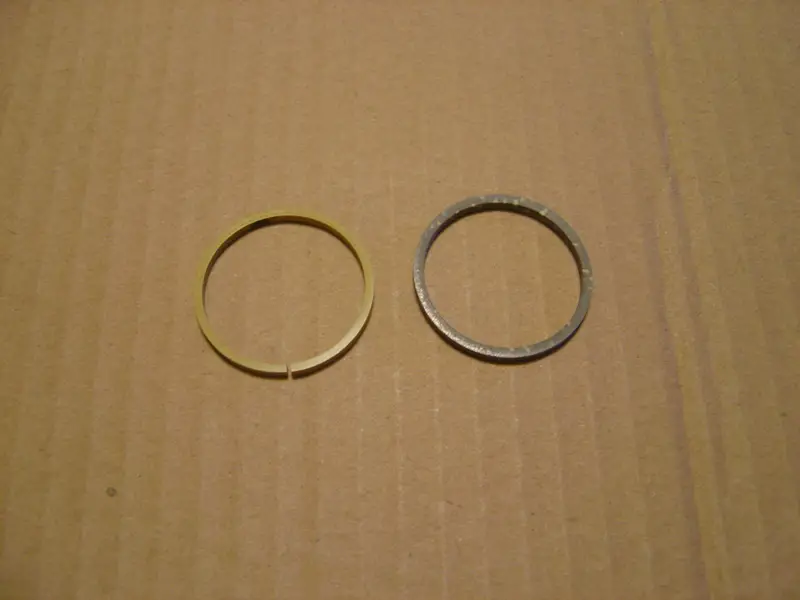

Get a stator seal too.
Seal
Got one from various seal/gasket kits I have acquired. I will have to look and make sure it is the one with no cuts in it....
Thanks for reminding me.
Stator Seal
Old vs. new style stator seals.
The old one is the yellow one on the left with the split in it.
The new one has no split and is supposed to have better sealing qualities and a more durable material.
They are about the size of a quarter in real life.
Drdoom, thanks again for reminding me, I will now have this ready when the torque converter shows up, so I don't forget.
I will be checking the pump oring, the one that is in the pump gear. I will be shining a light up in the pump where the torque converter goes and hopefully it will be in one piece still. I did replace it when I put the pump in. I have the Rotunda seating tool as well, and it does help get that thing to fully fit in the groove.

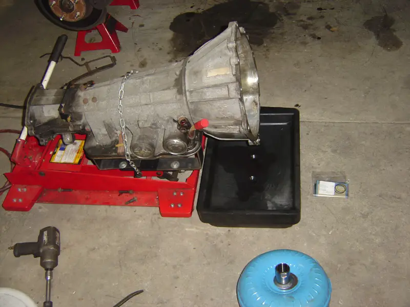

Done
Done but not road tested. I will see if it fixes the problem tomorrow night.
I ran the thing and filled the fluid but I have three trucks in my driveway blocking it in and it is too cold and I am too tired to mover them around.
Now its shower and sleep time.
In the picture you can see where I spilled all that trans fluid.
Love that harbor freight trans jack, I am getting my moneys worth out of that thing.
Note to self, jack it up higher next time.
