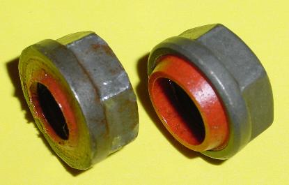

- Replacing the locknuts on the bands is probably a good idea when comparing one I took off with a new one.
http://www.explorerforum.com/forums/attachment.php?attachmentid=32654&stc=1
