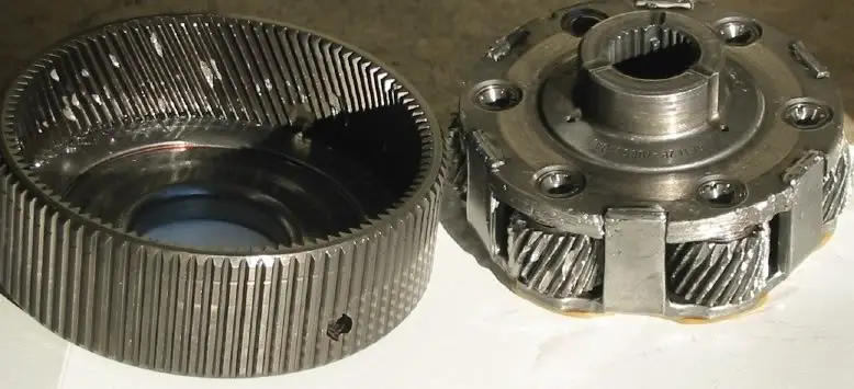

One of the Torrington bearings let go and basically exploded inside, tearing up most of the hard parts.

The planetary gears are completely tore up, you can see where the Torrington bearing let go, released all its nasty needle bearings, and took out the teeth:

A rebuilt torque converter was installed, most of the hard parts replaced with new, new servo's, and a new solenoid block were all replaced. All new bands and clutch material was replaced. The case was sent out to have the bronze servo sleeves drilled and installed. A Transgo shift kit was installed.
The shifts are now faster and a bit more firm.
