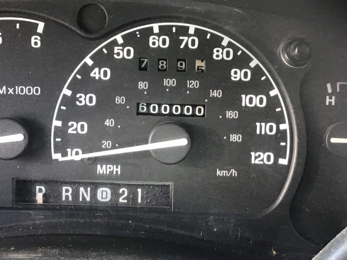

General Repairs and maintenance … Ford Tough, but this is 600,000 miles across 26 years. Certainly this is not a complete list, and many of these projects were done more than once. Did most of the maintenance myself, with lots of help from the Explorer Forum, and the local salvage yard.

Opinion: these trucks are tough, but at this age would be annoying and expensive if you do not do your own repair work.
THANK YOU to everyone on Explorer Forum!
