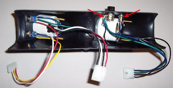

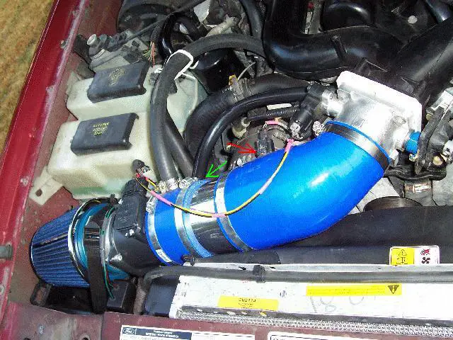

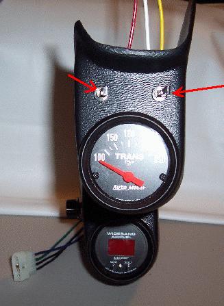

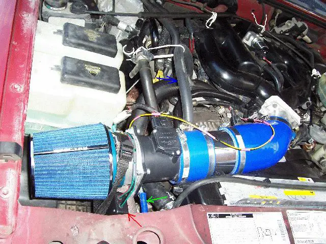

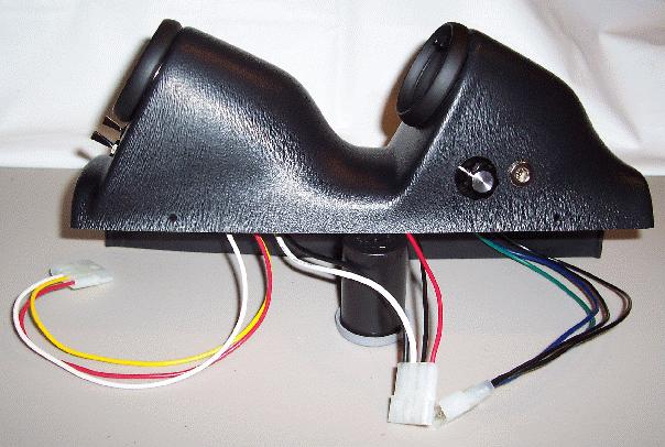

I've run several more 90mm MAF sensor tests and determined that the MAFSAmp output voltage was too high at idle instead of too low. For the latest test I reset the PCM by disconnecting and reconnecting the battery. The MAFSAmp gain had been adjusted for 0.55 volts out with richness pot at midrange, ignition ON but engine not running. The engine started fine but the idle was unstable. Adjusting the richness to minimum (lean) smoothed the idle throughout warmup. The MAFSAmp output at pot midrange was 1.05v and caused the idle to become unstable compared to pot lean (0.95v). With the pot at lean the engine seemed stronger and more responsive than with the stock (55mm) MAF sensor.
Below are the 55mm vs 90mm with MAFSAmp voltages to the PCM with the richness pot at minimum (lean).
rpm 55mm 90mm
550 0.8v 0.98v
1000 1.0 1.2
1500 1.25 1.4
2000 1.4 1.55
2500 1.55 1.7
3000 1.65 1.9
You can see from the table that the MAFSAmp voltage is still too high even for the pot lean setting. I'll try to readjust the gain so the output is 0.8v at idle with the pot set to mid range.
