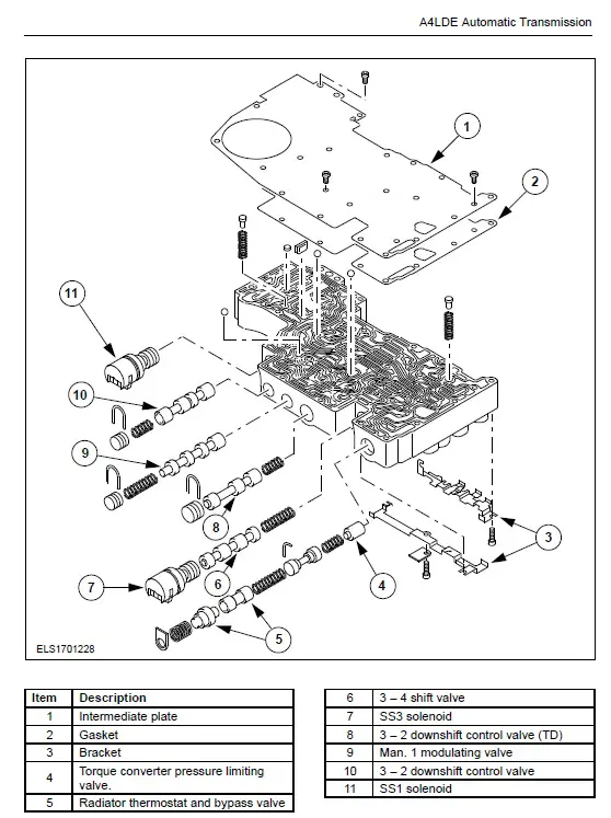

Return line of the transmission cooler? If i am not wrong there is a thermostat and a bypass valve (5) inside the valve body,
it should open when fluid is hot. With no temperature no fluid on the return line.

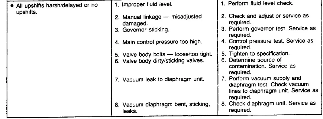

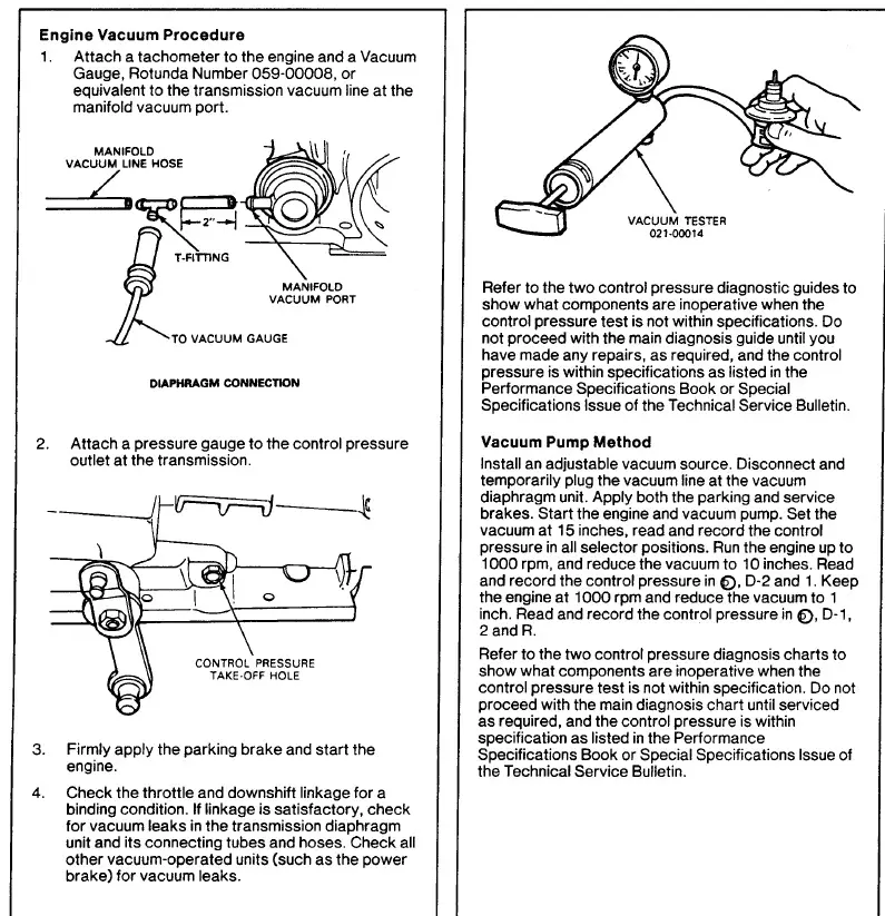

The transmission has a pressure test port, hook up a gauge to see if there is any pressure.
some other diagnosting
