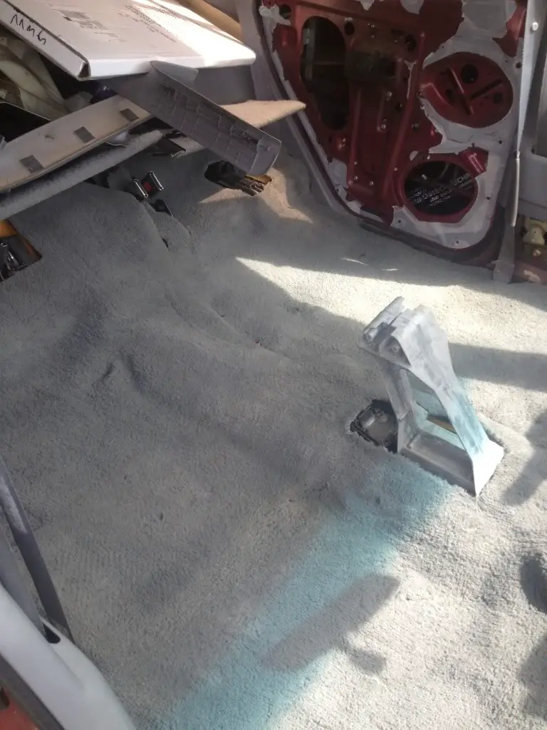

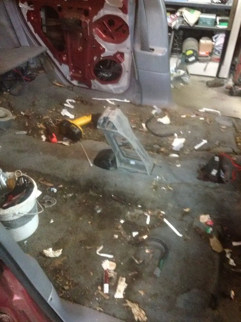

Carpet was TRASHED. after HOURS of scrubbing i got it cleaned enough to dye it. also ripped all the old jute padding off, that crap is horrible and is nothing but a place to hold moisture and odor.

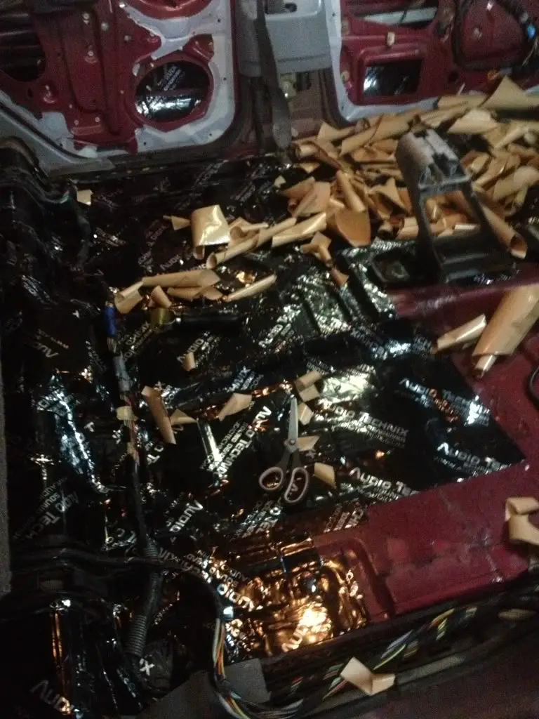

100% coverage on the floor of AudioTechnix deadener and a layer of 1/8" closed cell foam (yoga mat).

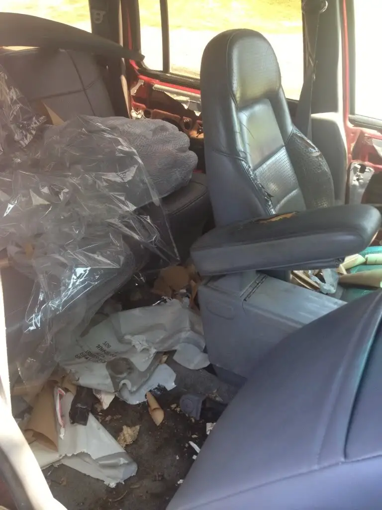

junk yard seats cleaned up nicely, before on left after on right.

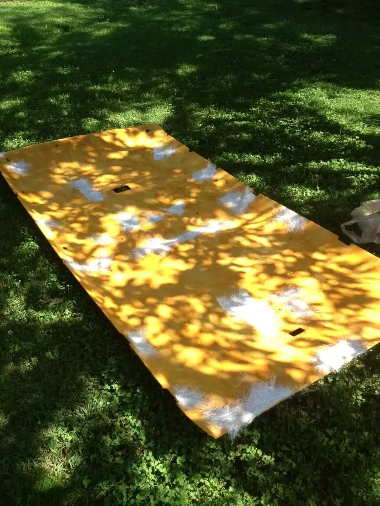

had to reinforce and patch up the busted original headliner board.

new headliner wrapped.

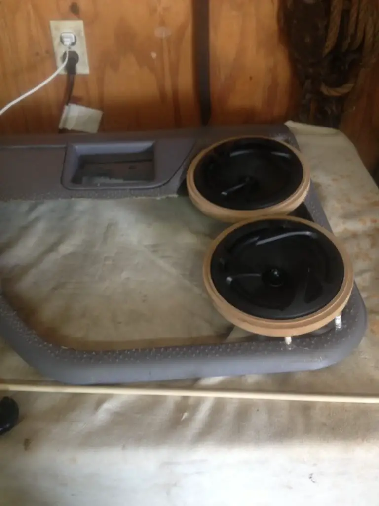

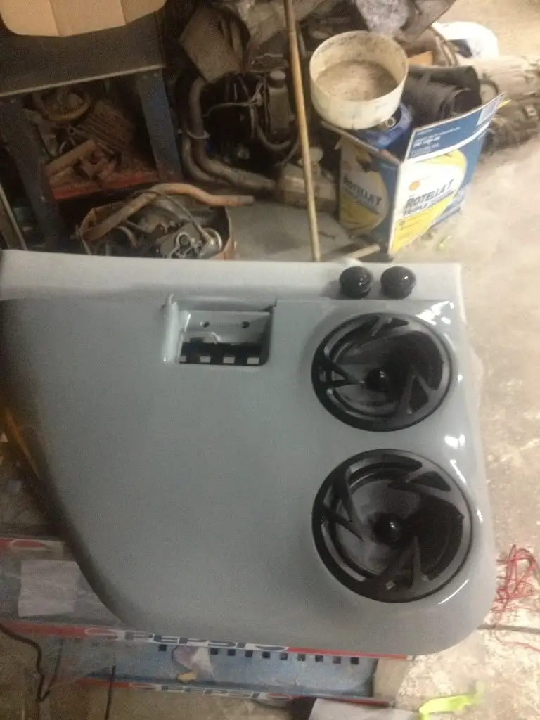

4 sets of Incriminator Audio 6.5 components

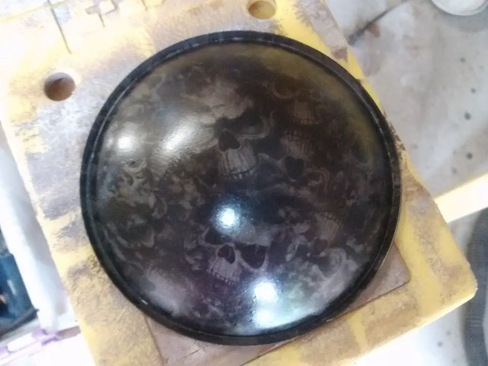

Had the dustcaps hydrodipped by a team mate:

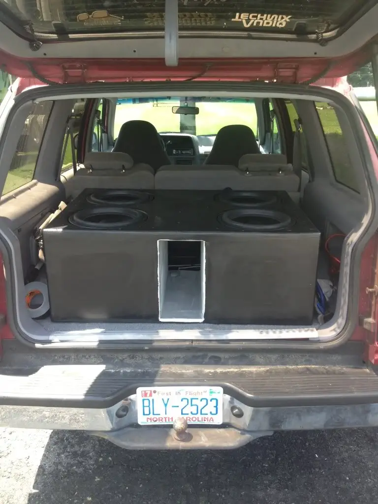

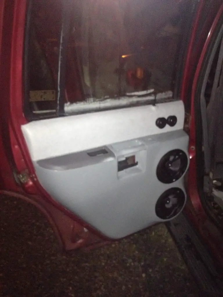

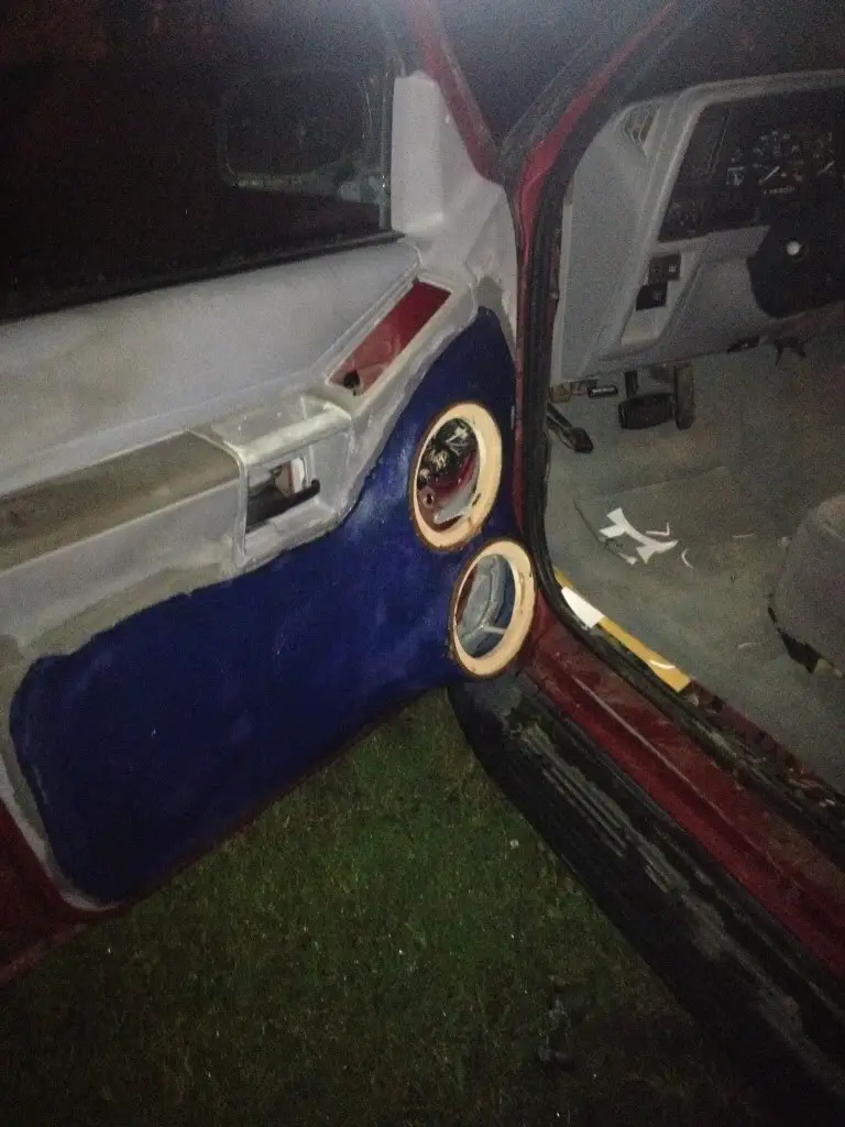

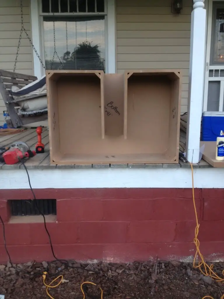

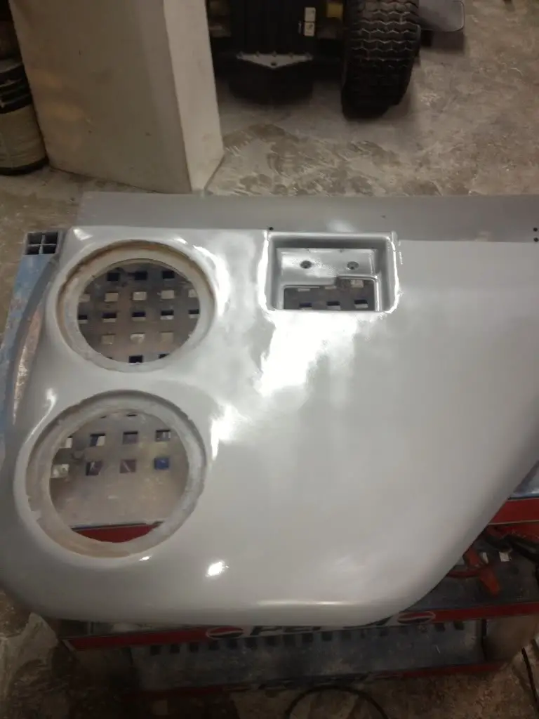

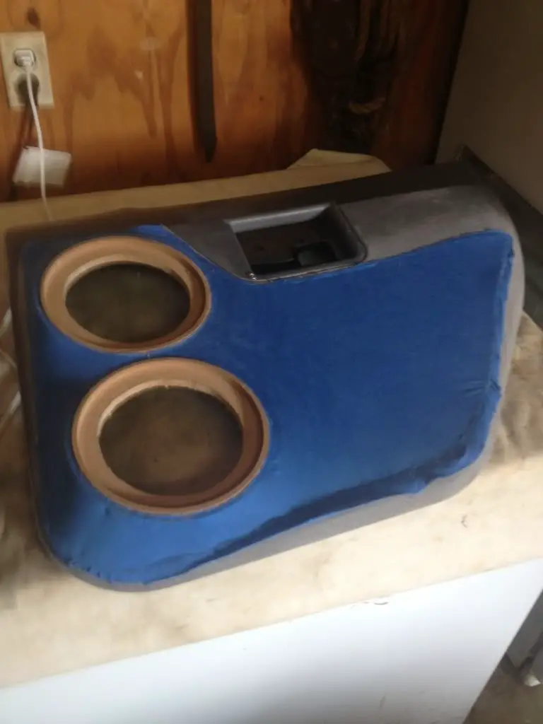

I still need to get one more Sundown 1500v1, I thought the 2 i had were both V1s but one ended up being a V2 (currently trying to sell it for $300 plus shipping, bot not much interest). need to pull the box back out and repaint it and pretty it up some. Also not happy with the top portions of my doors where the tweeters are, gonna redo that in suede and probably build it out a little to flush the tweets.
Still managing a 143.3 sealed on the dash on just one amp at 1ohm. Goal is 150+ staying below window line. Hopefully a new box tunes a little higher and the 2nd 1500 will get me there.

Got my 2nd amp in and wired up. Have 2 1500v1s strapped at 1ohm now on the 4 SA12s. sealed on dash @ 44hz im doing a 147.8 with no tuning. hopefully can squeeze a 150 on burp and 145 on music with this setup.

And, that's the first time I've seen the same seats as mine! :D
Get some more pics up!
Pulled em out of a local junkyard from a little newer explorer for $50 for front and back lol.
