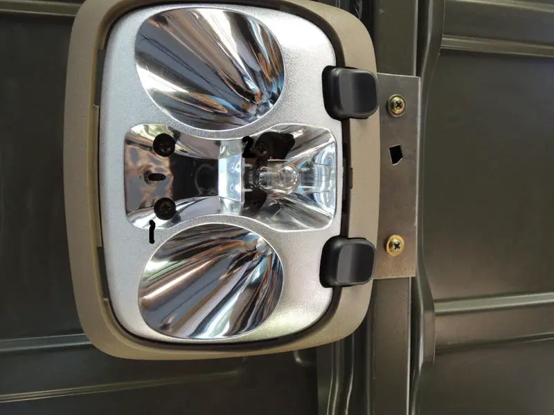

I replaced the headliner in my 93 Ex Sport this past week. After installing the headliner I tried to put the dome light assembly back up and I am at a loss at how to make the elec connection ?? When I removed the headliner initially, I noticed the dome light metal plate was bent down (I pulled on it by mistake) , so I carefully removed the elec harness attached to it. When re-assembling I must have moved something. I can't tell how this harness attaches to the dome light.
Please help - the headliner is in and I don't want to remove it. Any suggestions or pictures would help - Thanks

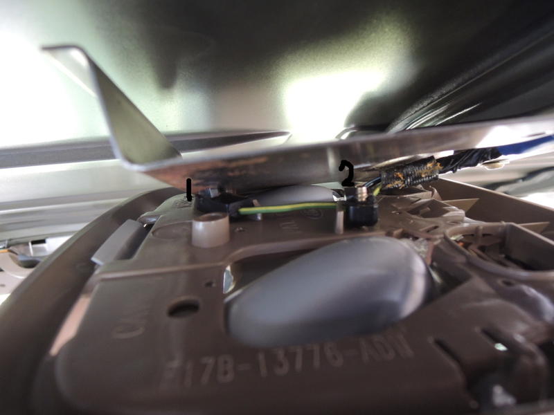

I have my headiner off right now, I took couple of pics.. Two of the screws have to go through a wire end connector is how the wire connects to the light.

Thanks VQ - I finally saw how they had to attach. These pictures you have taken are key for anybody replacing their headliner. You see, When I first tried to remove the dome light, I thought it required just pulling down from the headliner. Then I noticed the screws that actually held it up. Well, in pulling down, I bent one end of the metal bracket away from the adhesive surface on the roof (at opposite end of your 2nd picture). So, when I took off the headliner, I removed the bracket, and in doing so, undid the harness connections (#1 and #2 in your 2nd picture) from the bracket. I then reformed the bracket in my vice. Then it hit me that these wires (#1 and #2 ) were not ordinary connections and was at a loss on re-doing the connections.

Yes on the 2nd pic there should be a adhesive foam piece between the bracket and the roof to prevent it from rattling. I hadn't put mine back in yet cause I haven't put the liner back on yet. I might leave my liner off I kinda like this look now that its off. I took my liner off cause I am making a custom sliding shelf that hangs from the roof.
